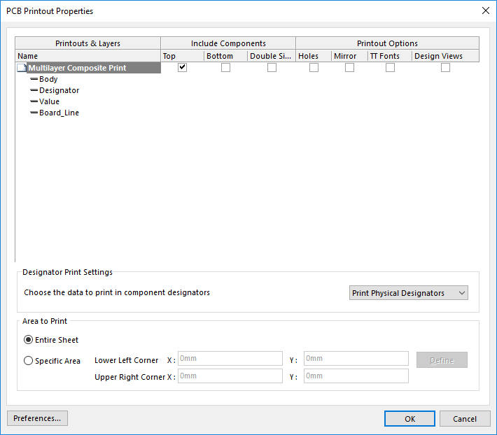

I am using circuit studio 1.3 and it seems to me that I found some bugs in "Generate output files" dialog.
First, I am trying to create a BOM file from my board. My board name is for example DD_1.3.Whan I leave it as is - all works fine! But when I am trying to add some characters in the end of name, CC generates a file with extension "all characters after dot". For example if I add a word "_new" to the name of my board instead of "DD_1.3_new.xls" I have "DD_1" file name with "3_new" file extension.
Second, when I am try to use "PCB print" option to generate a .pdf file for my board, again I open the  "configure" link and choose the layers I want to print.
But when I choose a mechanical layers, it is not appears in the final .pdf file. Instead of that when I open  "configure" link again, some of mechanical layers disappears from the printing layers list, some of them change its names.
For example here I want to print mechanical layer "Body", but it is gone when I press "OK" button and open "Configure" dialogue again.
When I am working with the same PCB in Altium designer, pdf and BOM files are generated correctly.

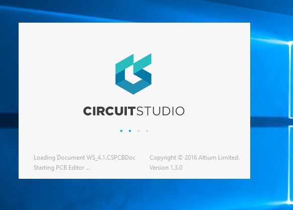

    Are you really using that version?  Can I ask where you got it?
    As far as I can tell V1.2.0 Build 37 is all the latest currently released.

    As you can see, I am really using CC version 1.3.0. I've downloaded ver. 1.2 from this site a month ago and than updated it to ver. 1.3.

    Thanks for that. I wonder why my copy isn't updating...  Anyway that's a topic for another thread.
