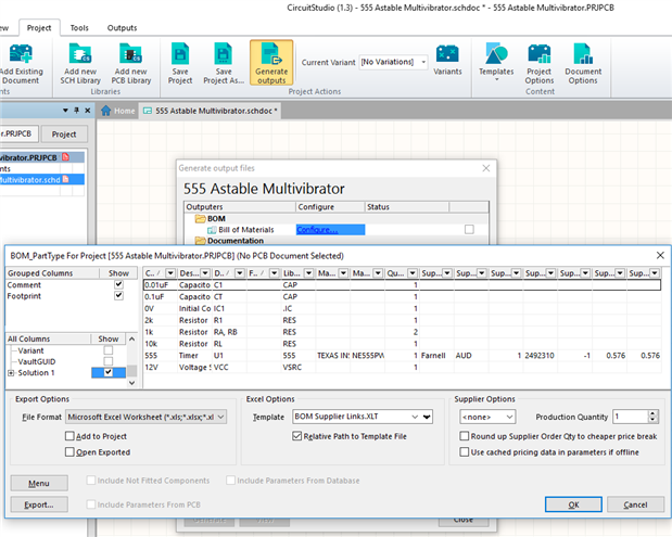

    CircuitStudio doesn't currently have this abililty within the schematic components. The outputs such as are available in the BOM when the Solution 1 field is enabled as per the screenshot so the prices are updated each time the Bill of Materials is generated.

    Is there a particular function you're interested in? One method of copying information out of the Supplier Links dialog is to select the wanted Name/Values and paste them into a spreadsheet. The Name and Value fields will be separated in the spreadsheet and can then be copied back to individual parameters in CircuitStudio.

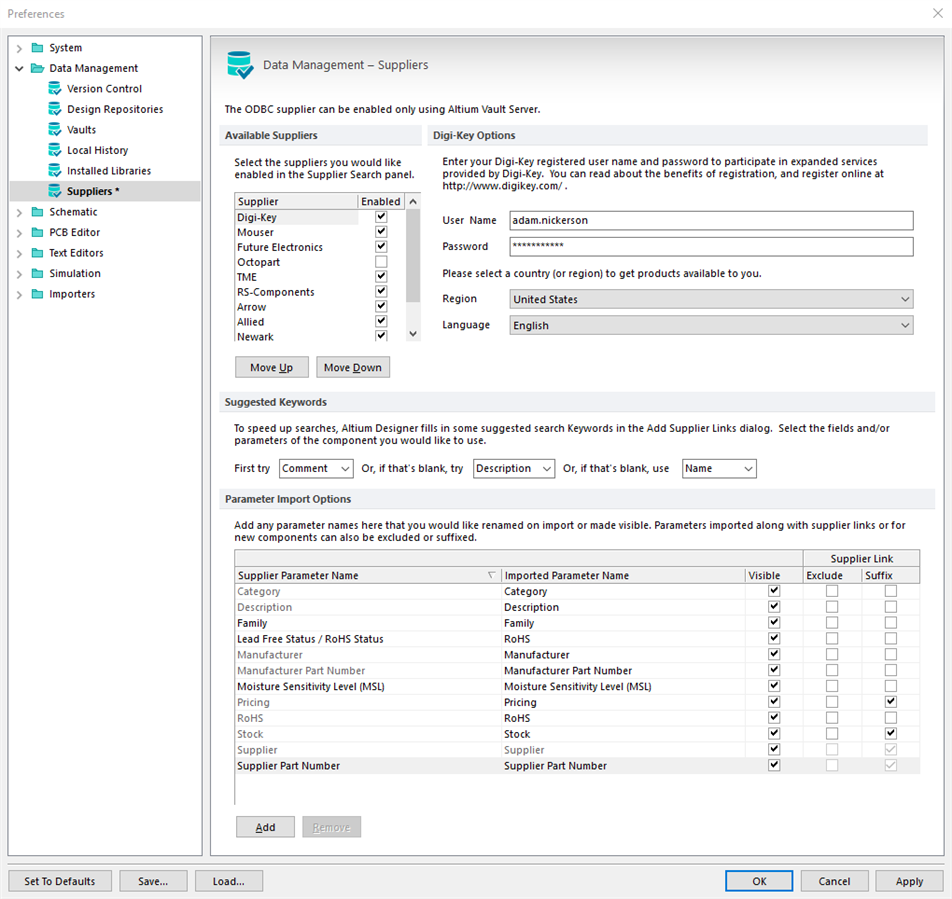

    Thanks for the reply. Along with supplier info, I would like the manufacturer and manu part number to be pulled over from the supplier info, as well as the description. What's confusing me is that there seems to be some configuration available in preferences, but that configuration is ignored. What am I missing?

    I was wondering the same thing, here is the menu.
    Under the system preferences is this menu and at the bottom is the parameter import options, the only two that we actually get when we add a supplier link to a part happen to be the two that have the suffix check box grayed out (Supplier and Supplier Part Number). Im guessing maybe this was an Altium Designer feature that got left out of Circuit Studio but it would make component design so much faster
