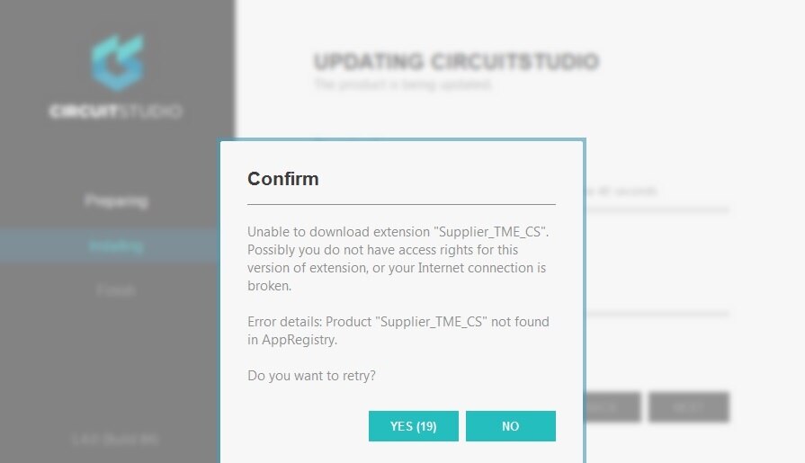

Because of BSoD problems with CircuitStudio on Windows 10 Pro ('Creators Update', see here, here, and here) I decided to boot up an old partition of Windows 7 and see if I couldn't get that running, but it was a 1.0 release. I was able to get up to 1.2.0 before I again started having problems. This time there seems to be a problem accessing and downloading a supplier plug-in because I can't get past the following error:
It doesn't seem to get past this no matter how many times I seem to press the 'YES' button, and wait. And, if I press the 'NO' button the installation aborts. Notice it's the 'App Registry' not the Windows Registry that has the problem. Was TME removed as a supplier in the 1.3.0 and later versions of CS?
At this point I can't fully use CS on Windows 10, nor can I update and use it on Windows 7. Nice.

    Just performed a complete removal and clean install, and I noticed I couldn't check the TME supplier box when installing the latest 1.4.0 build!
    Hmmm...
    Regards,
    Thomas
  • tlc8126
    tlc8126 over 9 years ago in reply to tlc8126
    That did it. Removing the old installation with the TME Supplier link/plug-in, and a clean install worked.

    Hi Thomas.
    We have fixed this issue.
    Can you try again?
    Thanks,
    Vlad
  • tlc8126
    tlc8126 over 9 years ago in reply to volodymyr.volotko@altium.com
    Vlad,
    Спасибо! It's working now!
