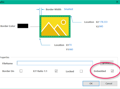

Hi,
When i try to import place an image in one of the schematic sheets it will come.But when i close the project and open it again it will not come or when i try to open it in another system it is not coming.

    Just a suggestion.  Check that you have Embedded the image in the file and not just linked it.
  • e14softwareuk
    e14softwareuk over 9 years ago in reply to yadhu22krish@gmail.com
    Thanks for the image. I saved locally and it does work without problem using the Home > Image option to add the image to a schematic, also you can drag the local image onto the schematic if you prefer. Thomas is correct in that selecting the Embedded option is safest otherwise just a reference to the file is stored and thus the image can go missing if the original file moves or is renamed.

    yadhu22krish@gmail.com over 9 years ago in reply to tarribred61
    Hi
    I ticked the embedded option
    Now its working..thanks
