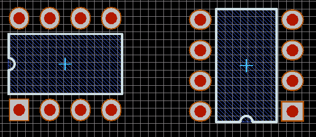

I've been trialing CS for a few weeks now - I have a bug I can't seem to find anyone else mention.

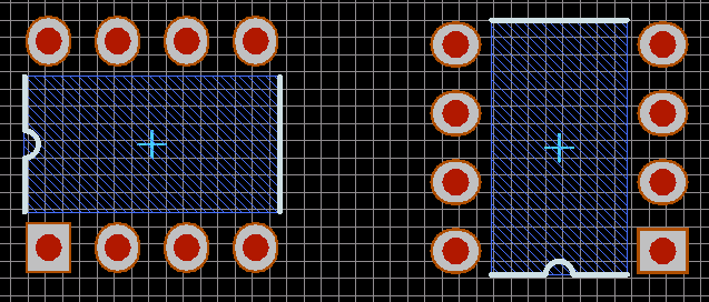

When I update a footprint in my PcbLib and push it to my PCB ("Update PCB with xxxx") the vertical or horizontal overlay lines may disappear. It's not just a rendering problem as the lines are not present in 3D view or on the Gerber outputs either.
PCB Library footprint
How it appears on the PCB - note the lack of horizontal lines on the DIP8 component and also the lack of vertical lines on C1 also caused by the same bug.
This is effecting a lot of my components, but not all of them. E.g. C1 (pictured) is bad, but most of the other capacitors using the same footprint are OK.

    I created a new Blank PCB Project.
    Dropped in a couple of my DIP8 footprints - they were OK to start with:
    Then I performed an "Update PCB with DIP8" and lost the lines:
    If I undo the footprint update (ctrl + z) the lines come back.
