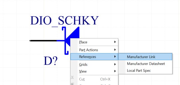

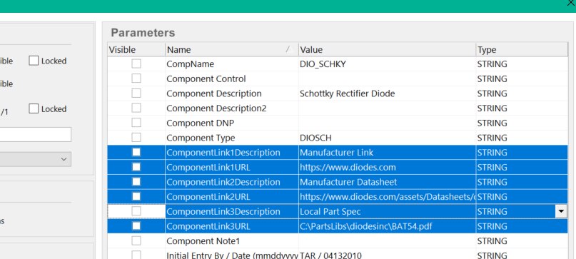

  • tarribred61
    tarribred61 over 8 years ago in reply to Sparkylabs
    If you are not aware of this it may be useful.  These are probably described somewhere in the Altium documentation and if you look for them you can learn more.  But it helps to at least be aware of their existence.
    There are a few special parameters that you can put in the schematic library that will link to the web or to a local file.  When you add these you can right click on the symbol on a schematic and pull up a data sheet or other web page through the references selection.
  • Sparkylabs
    Sparkylabs over 8 years ago in reply to tarribred61
    I'm sorry but what are you saying? is i use particular "key words" in the parameters CS will make their contents the subject of menu items?
  • tarribred61
    Yes, these particular parameters and their values allow you to get a right click link at the schematic level that will open a browser window for a url or even a PDF file at the schematic level.  It does not search these as supplier links for BOM though.  But you can cut/paste a link to Octopart there an quickly get reference information and price.  Unfortunately, like all web links, they tend to go dead periodically but that is not a fault of CS.
