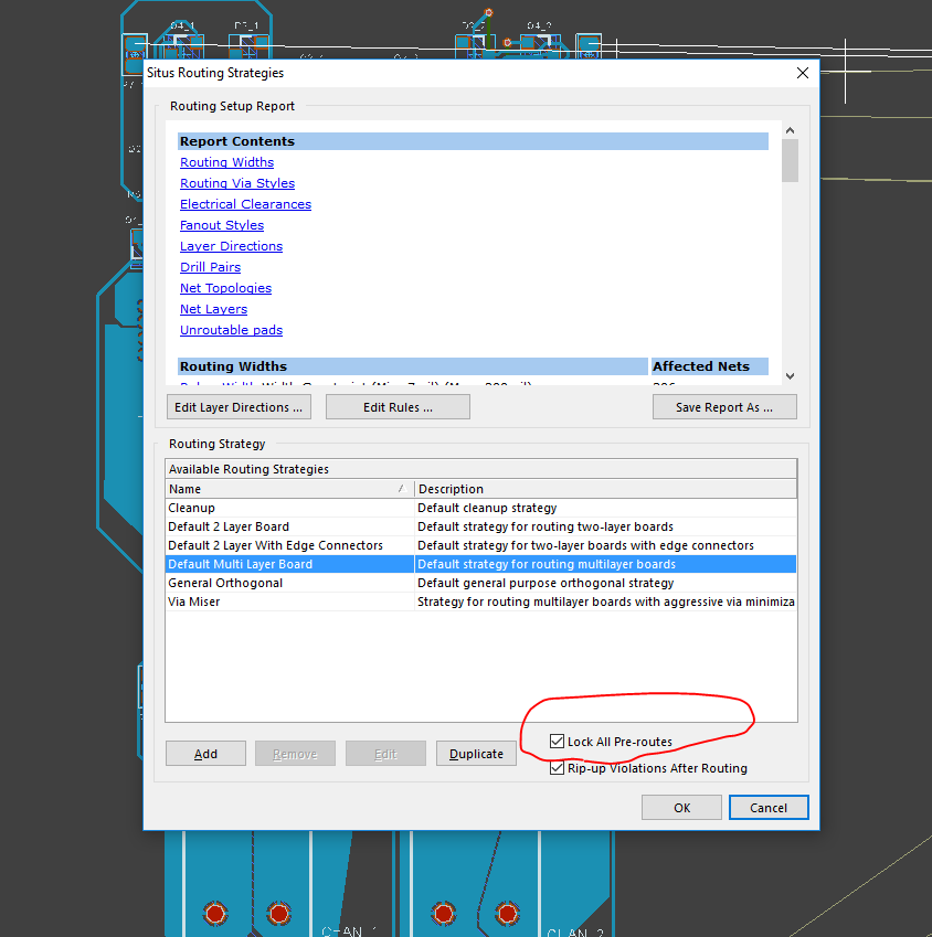

Bug report.
See related discussion here:
How do I create a polygon from a region or a fill, or add keepout property to a polygon pour?
So, to all who want an editor that has a useful autorouter, don't buy CircuitStudio!
  • jaza_tom
    jaza_tom over 8 years ago
    Never mind, I actually figured out how to do this:
    You need to select the Lock All Pre-routes option in Tools-->Autoroute-->Setup
  • jaza_tom
