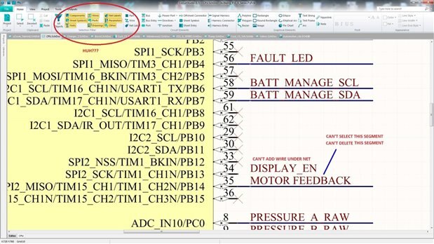

I just installed CS v1.5 and started to edit a schematic started in v1.4, but immediately encountered major problems.
1. I tried to copy a Net Label to an additional pin but it copied text instead of a Net Label there. Then I had a great deal of trouble selecting and deleting the text.
2. Then I had a great deal of trouble adding a Net Label to the same pin, instead it added a line vertex everywhere I tried to plunk down the Net Label.
3. Then I had a great deal of trouble selecting the line segments either directly or with a window, to delete them, ultimately unsuccessful (see attached image).
4. I noticed that many menu items will all turn on at the same time (see attached image).
Didn't look any further. These are show stoppers.
Please advise how long I can expect for this to be remedied so I can complete the clients job, or how I can revert back to v1.4.

    Changes made to the 'Home' toolbar are misleading. They moved the 'Filter' toolset from the 'View' tab to the 'Home' tab and put it on the left side, where you expect to find tools like 'Wire' and 'Net Label'. Look a little further to the right and you'll see the tools you are looking for...

    Thanks Paul
    That little item ( a friggin' menu change ) would have been worthy of mention!
    Be sure to have something selected in this new filter menu, or you won't be able to select anything in your database apparently!
    I have an idea, why don't they just go back to the AD drop down menus and save the world a lot of trouble!? image

    I think that you actually don't need to select anything in the Filter toolset to have access to all objects, but there are some confusing situations you can easily get into, where you inadvertently click on something in the Filter toolset and don't follow through with a selection.

    Hi Mark and Paul,
    The filter introduced in 1.5 is new in Schematic and is an additional filter in PCB, so both editors have a consistent filter.
    The Selection Filter enables selection of certain types of objects, OR'd together, e.g. a Component OR a Pad. Press both buttons so they are yellow, then make a selection on the PCB and only components and pads can be selected, but other objects can't be selected.
    Press the All Objects button (it becomes yellow), to enable all objects to be selected.
    Please note that the shortcut Shift + C will clear the selected objects in the schematic or PCB editors but will not change the Selection Filter buttons.
    Conversely, changing the Selection Filter buttons doesn't change the selection of objects. Therefore you can change the buttons and then add extra objects to your selection by holding the Shift key while selecting around other objects.
    Always check the bottom of the Inspector panel (F11) to see how many objects you have selected to ensure that your selection is what you intended.
