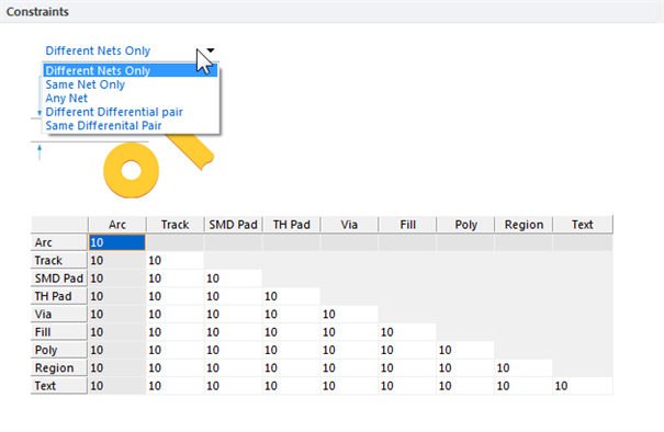

Hi,
Is there a way to define different values for hole to hole clearances based on nets?
One value for via holes in same net and another value for via holes in different nets.
Thanks in advance!
  • e14softwareuk
    e14softwareuk over 8 years ago
    The design rules allow for setting a clearance between objects of the same net. You will need to create a new rule and set the type of clearance to same net only.
