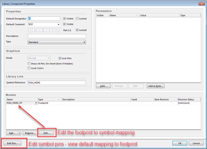

Link the footprint model to the schematic symbol.  Click on the Edit Pins button in the Library Component Properties dialogue box.
The pin names for the footprint are incorrectly labelled "P1", "P2", and "P3" etc

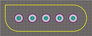

    Create a footprint
    Footprints typically have pad names starting at 1 and follow the pin numbering sequence as shown in the device datasheet. Here's a very simple 5 pin header with pins numbers 1 to 5.

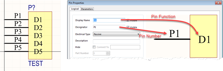

    Create a schematic symbol
    Note that each pin had both a name and designator, typically one would be the pin number (known as Designator) and the other a pin function name (known as Display Name).
    It is the pin number (Designator) that is used to tie up symbol pins to footprint pads. Bring up the component property dialog and add in the footprint just created.
    There are two very similar buttons. Edit Pins is designed to edit the symbol pins and it also shows the current mappings of symbol pins to footprint pins. Seeing entries in the mapping does not imply the footprint has a pad of that name - it is just showing that pad names that will be used when trying to match up with the footprint.
    The Edit button is used to assign symbol pins to footprint pads and a different mapping can be used for each footprint. The image below shows the edit button being used to assign symbol pins to footprint pads, the first two have already been changed to match what pads the footprint had to offer.
    Once the mapping is complete everything will work as expected.
