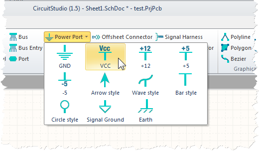

    I think I should have clarified in my original post that the net I'm trying to change the name of is actually a power port.  Dropping a net label onto any net connected to that power port indeed seems to change the name of all the nets connected to other versions of that power port.
    So, I guess what I really want to know is how to change the name of a power port across an entire schematic.

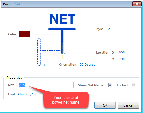

    Changing the name the net associated with a power symbol should be easy. Drop a power port onto the schematic then bring up the property dialog and change the net name.
    Use property dialog to change the name
    For regular nets across multiple sheets it is the port name that is important, the net labels are local to a single sheet only.
