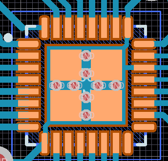

    Hi Marius, wish I had your post before I had tried to figure that out.  I'm curious if you've dealt with adding vias to a pad under a QFN, i.e. the area is meant to be grounded as well as thermally tied to as much copper as possible. I've been able to get the vias in and adjust the solder mask to not cover them, but it seems like something in the DRC doesn't like what I've done - it's been a while but I think the via spacing trips it up as it doesn't think it's all tied together ?  I work around it by adding a rule for the footprint but it would be nice to either understand how to add vias to the footprint in way that the DRC is happy with or include some sort of info in the footprint that tells the DRC to skip it (not sure that's possible, as while layout has a pad class property doesn't seem to be any way to use it?).
    Why would would you not want solder mask covering these vias?  If you do not have solder mask on these vias, then they will get soldered to the bottom of your QFN chip when it comes time to assemble the board...
  • lamabrew
    lamabrew over 8 years ago in reply to jaza_tom
    oops, my bad. I meant to say: adjust the solder mask so that it surrounds the pad and the stencil so that paste is not in the via area (as per manufacturer's recommendations). Like this:

    lamabrew over 8 years ago in reply to mars01
    Hi Marius,
    Boy my earlier convoluted comment made a mess of the thread...sorry for the confusion. I am referring to adding vias in the ground/thermal pad under the QFN, and fighting with the DRC to not have it flag all of the vias as violating clearance rules.
    I went back and reminded myself how I fixed that - I was thinking I had set some rules based on the footprint but that was for a different part; I got the QFN to work by assigning the pad to the ground net. Not sure why connecting it with vias to ground didn't make it part of the net but that seems to have stopped the DRC errors.

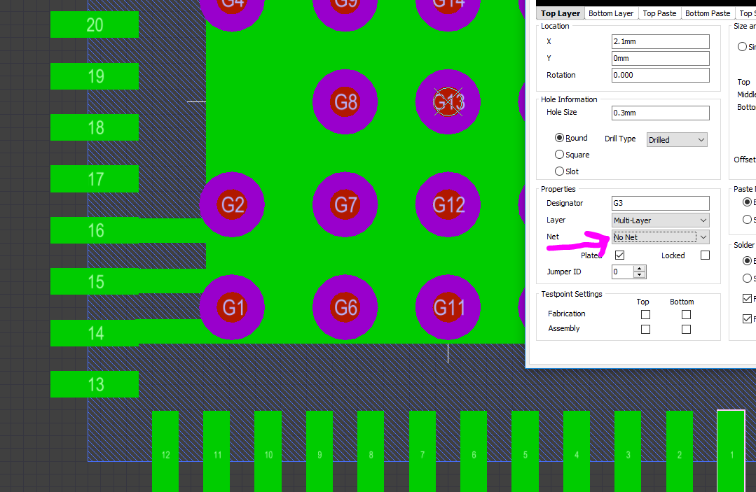

    olemi over 7 years ago in reply to mars01
    mars01
    Marius, do you know how to assign vias under QFN while doing footprint to a specific net (GND)? In the Net properties dialog for pads is always "No nets". Libraries are added (linked) to the project with multiple nets.
