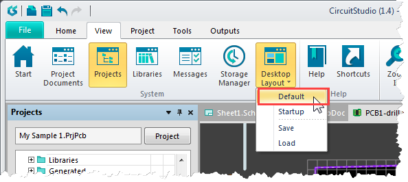

The workspace of CircuitStudio is very flexible with many optional panels/windows and great flexibility about placement, either floating, tabbed with other panels or docked to the main application window. With all this great flexibility it is sometimes possible to accidentally position a window off screen making it difficult to recover. The following simple procedure will reset your project workspace and window positions back to program defaults.
A small number of users report random crashes when using CircuitStudio. Sometimes it is a graphics driver that needs updating, other times it may be a printer driver. After trying the usual options of making sure operating systems and drivers are up to date and anti-virus is not interfering it can be worth trying the following reset procedure. We do have some confirmed instances where this has resolved the issue so we do recommend giving it a try.
An easy first step is to use View | Desktop Layout, select Default to reset the windows and panels back to their default settings.

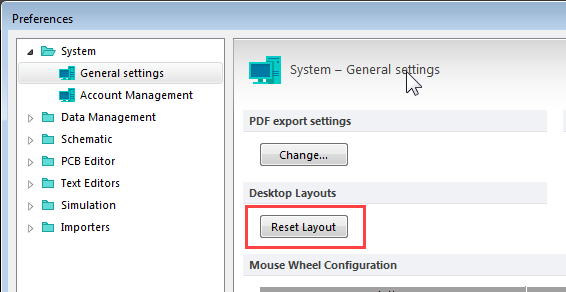

There is a reset option built in to CircuitStudio under File > System Preferences, System : General Settings : Reset Layout. This is always worth a try but does not always reset everything so there are a number of other options to explore below.

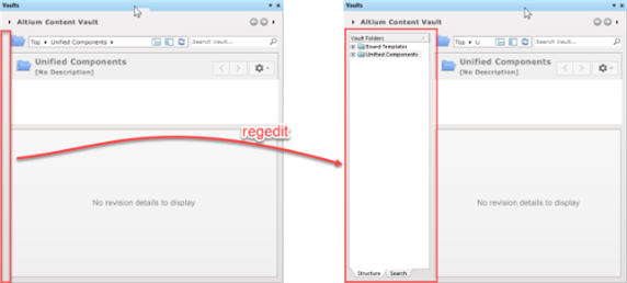

Vault Explorer Tree View
The various sections within the vault explorer window can be resized, however there is an issue (confirmed in v1.4.1) where if you resize the left hand tree view down to zero then it is not possible to restore the width. Editing the registry can restore the tree view width so it becomes visible again.
Run regedit
Navigate to HKEY_CURRENT_USER\Software\Altium\CircuitStudio {guid}\DesignExplorer\Preferences\EDesignData\VaultExplorer_Size_B7D15EC3-160A-466F-A46C-7801FE6295A7
Adjust TreePanelWidth (example, set to 100)
