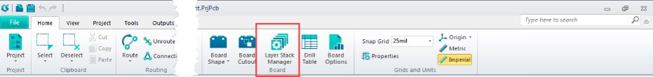

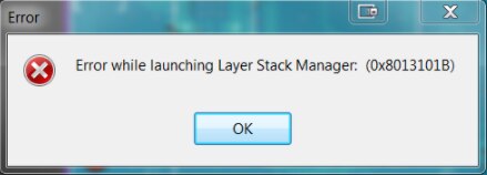

Error launching Layer Stack Manager
We have a couple of suggestions to try if you encounter this error (which seems to be a very rare occurrence).image
#1 : Remove Projects and Reboot
Close all projects and documents, the View | Projects panel should be empty.
Shut down CircuitStudio then reboot the computer.
Add back in a project and test the Layer Stack Manager.
#2: Repair .Net Framework
The Microsoft .Net components of Windows (for example, version 4.5.1) may require repairing.
To fix this, run the .NET Framework Setup Verification Tool available at http://blogs.msdn.com/b/astebner/archive/2008/10/13/8999004.aspx.
If the .NET Framework installation is available in the Windows Control Panel: Program and Features section, double click on the application, select to repair the .NET Framework to its original state. (This may not be available in newer versions of Windows).

    ayeye over 7 years ago in reply to e14softwareuk
    I reinstalled and that has fixed it! Thank you!
    I have however managed to remove my custom libraries in the process which i've spent the last 3 years building.... I unticked the remove personal things etc when i uninstalled but obviously libraries aren't part of that. I had assumed I was working off of my server library file but alas.... I'm a dummy. Thank for the help though. I'll just be rebuilding as I go
