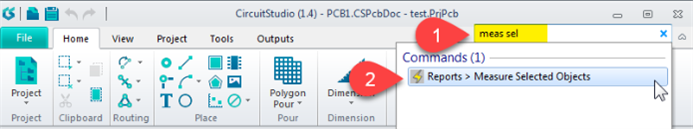

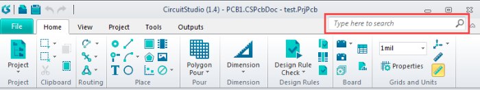

CircuitStudio, through its use of a modern ribbon interface, is designed to be easy to use and accessible to those whose full time job is not PCB design. Those wishing to access the full power of the product will be interested in these extra commands that are not accessible via a button or other dedicated UI element.
The following are accessed by typing a search string into the search bar on the upper right of the editor window.
The search string should be the command name or a few characters from it so that it will be returned in the search results dropdown.

Convert > Create Region From Selected Primitives
Deselect > Touching Rectangle
Deselect > Touching Line
Design > Make PCB Library
Paste Array...
Pin/Part Swapping > Automatic Net/Pin Optimizer...
Pin/Part Swapping > Configure...
Pin/Part Swapping > Interactive Differential-Pair Swapping
Pin/Part Swapping > Interactive Part Swapping
Pin/Part Swapping > Interactive Pin/Net Swapping
Place > 3D Body
Report > Measure Selected Objects
Select > Touching Rectangle
Select > Touching Line
