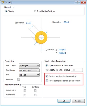

Each via can be controlled individually by bringing up the property dialog (right click > Properties).

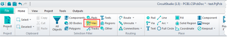

If you have many vias this can be tedious and a different technique can be used. Apply the via filter (see image below) and then select all objects (CTRL+A).

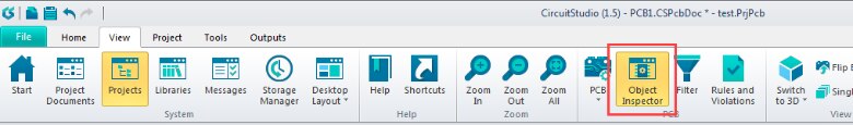

Next select View | Object Inspector if not already active.

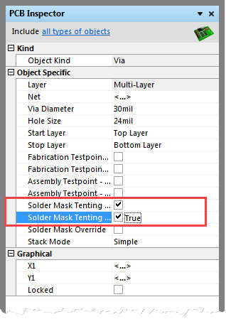

From the PCB Inspector panel the tenting option can be applied to all selected vias.
