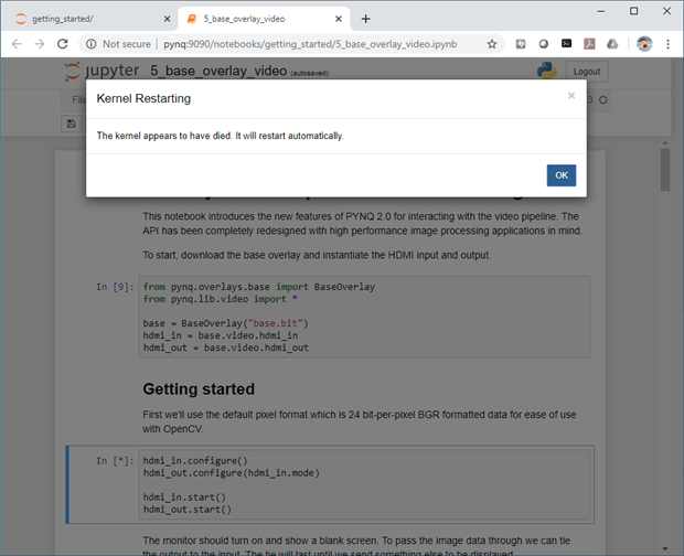

I'm currently making sure I'm in a good position to hit the ground running with the upcoming PYNQ-Z2 workshops. I bought the recommended kit including an Apeman A77 camera and thought I'd just have a quick poke around in advance. I ran through the "getting started" and the Pynq 2.5 image includes some simple HDMI examples. (I hope I'm not jumping too far ahead, but like to be prepared.)
Anyway, as I start to run the HDMI example I get a kernel died error (as shown). You can see on screen what's been run. This is just wiring HDMI out to show what's on HDMI in. The error is completely repeatable. Nothing noteworthy in /var/log/jupyter.log to give any clue.
As quick Google suggested that maybe the image is too high resolution, and when I checked the camera on my TV it outputs 1080p at 60fps regardless of the resolution of video being captured. Could 1080p be too much?  Time to switch to a Raspberry Pi 4 where I can change resolution properly. The above example ran quite happily with the Pi at a lower resolution, but surprised me when it also ran using the Pi at 1920x1080 at 60fps too.
Is this camera (Apeman A77) compatible with the HDMI on the PYNQ-Z2? I'd have expected it to be as it was the recommended kit and the Crosstour one listed now is essentially the same model.
I'll try to do more digging into any subtle differences between the HDMI output of the Pi and the camera, but all I have is a TV that shows some info on the input. Anyone else have any ideas?

    Are you aware that the HDMI out IP provided in the PYNQ-Z2 the base overlay doesn't fully support 1080p video ? https://pynq.readthedocs.io/en/v2.5.1/pynq_overlays/pynqz2/pynqz2_base_overlay.html#hdmi…

    Thanks for all your help beacon_dave My TV reports that the Pi and the camera are outputting the same format - 1080p60, sYCC601 colourspace, 8-bit depth, and YCbCr 4:2:2 pixel format. I tried connecting…

    I wasn't aware of those details. Maybe that's it - a borderline implementation of 1080p where output from the Pi 4 works and the camera doesn't. If that's the case it's frustrating that a recommended camera…

    Unfortunately the A66 doesn't appear to work with the PYNQ-Z2 as a live video source, so another one to avoid for this workshop.
    The best I was able to get it to do was to display some low quality still photographs from its microSD card via the PYNQ-Z2 and only after first establishing the video connection on the PYNQ-Z2 using a low-end CP-255D video scaler as an HDMI source first.
    It looks like the micro HDMI output on the A66 camera is only intended for playback of still photos from its microSD card. For live video, it would appear that you need to use the USB webcam mode.
    The A66 camera was able to detect the PYNQ-Z2 initialising the HDMI interface as it switched to external display mode whilst executing the code in the Jupyter notebook.

    I also did verify that if I run the camera at a higher resolution than 1080p60 that I do kill the kernel.

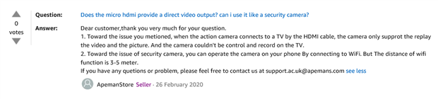

    I was looking through the Q&A on Amazon for the A80 camera and spotted this:
    which sounds the same as what I'm experiencing on the A66 version of the camera.
    It looks like current versions of the camera no longer support the live video out on HDMI feature that previous versions supported. Does your A80 have the 2" screen (diagonal) or the smaller 1.8" one, as this may be an indicator of when features changed ?

    In the meantime I've ordered up one of the latest recommended Crosstour action cameras, as one of the sellers appears to suggest that they will do live video continuously out of the micro HDMI port:
    however that was posted over a year ago, so if they have undergone the same firmware updates as the Apeman range of cameras appear to have, then I may still be no further forward.
