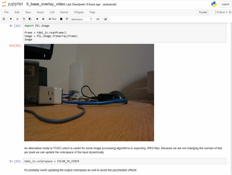

    I saw this discussion but I haven't used my PYNQ-Z2 in a while and I'd never used it with an HDMI source.  Since I've only tried PYNQ V2.5 with my Ultra96-v2 I thought I should try it out with the PYNQ-Z2 before the workshop.
    I have an Apeman A80 and I tried it out with that same base_overlay_video notebook that you tried.  I have the camera resolution set for FHD P60 and it seems to work fine.
    Here's the image capture of my desktop from further down the notebook:
    The only time I killed the kernel was when I tried to execute the following cell before the base overlay had completed loading (I wasn't paying attention...).
    Just thought that I'd let you know that my camera is working.

    I did try COLOR_IN_YCBCR but with the earlier example. I'll try with that one when I get a chance but as it blows on hdmi_in.configure() I expect it will be the same.
    Glad to hear your A80 is working. It's a later version of my A77 so maybe there are a few improvements. I can see already you've turned off the on screen display of battery level, etc. which I can't do on the A77.

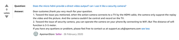

    I was looking through the Q&A on Amazon for the A80 camera and spotted this:
    which sounds the same as what I'm experiencing on the A66 version of the camera.
    It looks like current versions of the camera no longer support the live video out on HDMI feature that previous versions supported. Does your A80 have the 2" screen (diagonal) or the smaller 1.8" one, as this may be an indicator of when features changed ?
