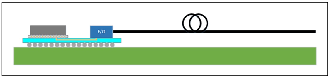

Traditionally, high-speed interconnects have relied on backplane connections for in-rack communication and pluggable optical transceivers for longer intra-data center links. However, as data rates reach and surpass 224Gb/s, electrical channel losses have emerged as a major limitation. This has driven a shift toward co-packaged solutions, where optics or copper interconnects are integrated directly with the switch ASIC.
Co-Packaged Copper (CPC): CPC presents an attractive option for short-reach connections within data centers (typically under 2km). By minimizing the need for power-hungry optical conversions, CPC enhances signal integrity while reducing both latency and power consumption. Though its range is shorter than that of optical solutions, CPC is well-suited for intra-rack and short inter-rack applications.
Co-Packaged Optics (CPO): Co-Packaged Optics is re-emerging as a compelling solution for high-speed intra–data center interconnects. By integrating optical components directly onto the same substrate as the ASIC, CPO minimizes electrical losses and delivers significant gains in energy efficiency. However, its adoption also introduces new challenges—particularly in thermal management, integration complexity, and manufacturability.
