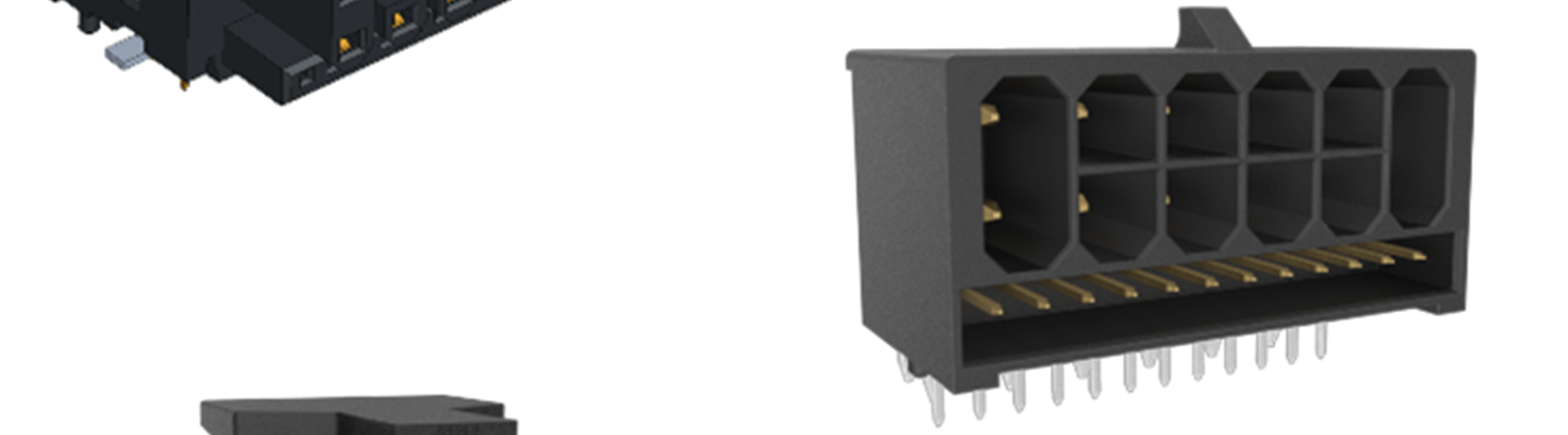

A recent webinar hosted by Amphenol Communications Solutions showcased the Minitek® Pwr family, a versatile and high-performance range of power connectors designed to meet the evolving demands of data centers, EV systems, industrial automation, and consumer electronics.
Presented by Jithin George, Product Manager for Minitek Pwr, the session explored how this product family delivers compact, reliable, and flexible interconnect solutions across multiple industries from GPU systems and OCP servers to robotics and EV battery management systems.
Minitek® Pwr Overview: Compact Power with Big Performance
The Minitek® Pwr series represents Amphenol’s optimized mid-power connector platform. It combines high current-carrying capacity, mechanical robustness, and design versatility.

All Minitek® Pwr connectors are available in single and dual-row options and feature LCP and Nylon housings for high-temperature resilience. The series supports up to 28A per circuit- making it ideal for compact power systems that demand both density and performance.
