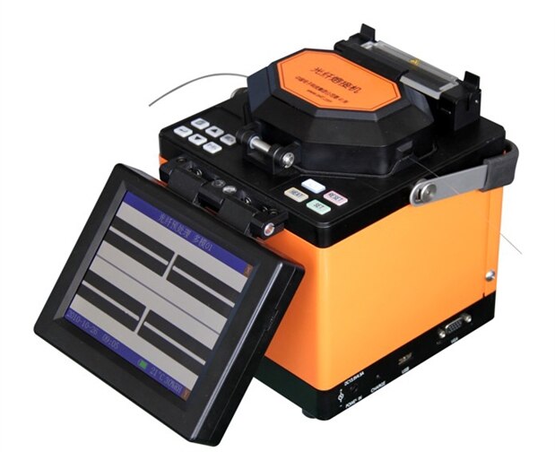

SUN-FS1030 Single Fiber Optic Fusion Splicer
SUN-FS930 Single Fiber Optic Fusion Splicer
Features:
Automatic selection of optimal fusion splice program
Automatic detection of fiber end face
Automatic calibration of arc discharge
Automatic fiber alignment function
Automatic calculation of splice loss
5-inch color LCD monitor with clear digital image display
Dual mode of view, separately view of X/Y axis, simultaneous view of X and Y axis
Wind resistance function
Built-in battery
FTTX FTTH solutions
Specifications:
Applicable Fibers    SM, MM, DS, NZDS
Fiber Cleaved Length (mm)       12 ~ 16 (Coating Dia.: 250um)
16 (Coating Dia. 250 ~ 1000um)
Fiber Diameter (um)      Cladding diameter: 80 ~ 150
Coating diameter:100 ~ 1000
Fiber Count       Single
Fiber Aligning Method  Core aligning
Return Loss (dB)     >60
Actual Average Splice Loss (dB)      0.02(SM), 0.01(MM), 0.04(DS), 0.04(NZDS)
Splice Mode      Auto & Manual
Dimensions (mm)   150(L) x 150(W) x 160(H)
Weight      3.52Kg including battery
Features:
Built-in battery
FTTX FTTH solutions
Specifications:
Fiber Count       Single
