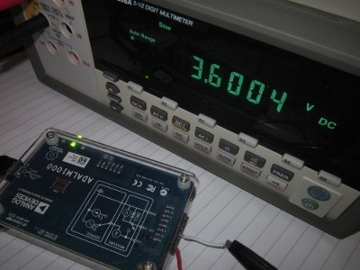

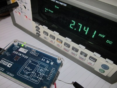

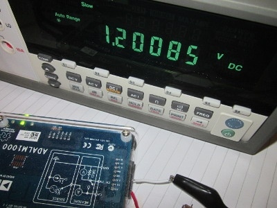

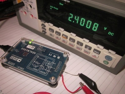

  • jc2048
    jc2048 11 months ago
    Thanks for the blog, it's interesting to see what you've done with the Python automation (not something I'm very good at).
    I'm surprised you're seeing the voltage source values so far from what they're being set to (200mV away isn't 'slight'), and you might want to investigate further what the reason for it is.
    This is mine set in turn to 0V, 1.2V, 2.4V, and 3.6V. That's with no load (other than the meter - 10G on the ranges to 2V, and 10M above). The test meter hasn't been calibrated for years, but I don't suppose it's too far out. The results are quite reasonable for what the M1k board is intended to do and the price it sells for.
