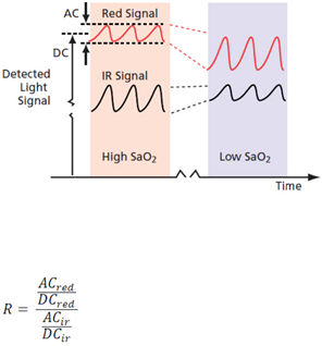

    Hi,
    Please check this TI app note for calculating SpO2. The same approach is applicable to maxim chip.
    http://www.ti.com/lit/an/slaa655/slaa655.pdf
    in brief SpO2 can be calculated
    R = (AC RMS of Red / DC of Red)/ (AC RMS of IR / DC of IR)
    SpO2 is a percentage value. Using the R value you can calculate the %SpO2
    % SpO2= 110 – 25 × R
    AC RMS is the RMS value of voltage difference between peak and trough of the RED/IR waveform.
    DC is the voltage difference between ground and the trough waveform.
    Please ping me in case if you want any more help.
