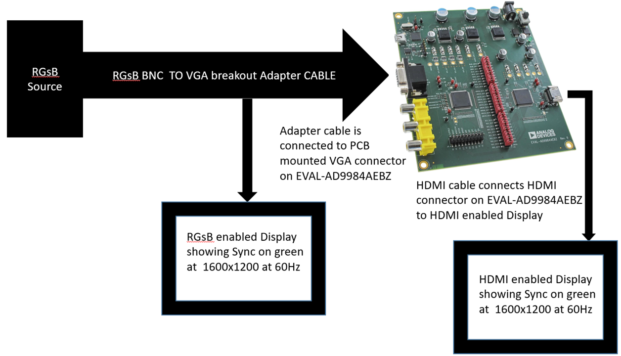

1. We have interconnected EVAL-AD9984AEBZ board with our test bench as given below:
2. We first switch "ON" RGsB video generator source. Then changed the settings on VESA complaint Sync on Green Analog signal with 1600x1200 pixels at 60 Hz.
3. We checked RGsB display, if this display is working correctly. We found that above shown RGsB Display was actually showing Sync on green signal. Now, we can actually change the resolution of Sync on green video signal.
4. We connected EVAL-AD9984AEBZ to CPU using USB cable provided -> this made USB PWR LED (D7) glow onboard & switch "ON" the EVAL-AD9984AEBZ board using AC to DC adapter provided with board -> this made main power LED (D6) glow on board.

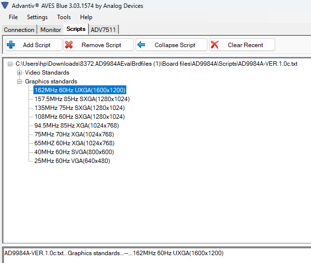

5. Now, we loaded  AVES Blue & selected the connection tab. Thereafter, double clicked on CY7C68013 which actually  connect this board with Windows based PC.
6. We added "AD9984A-VER.1.0c.txt" script in AVES Blue which gives us the options given below:
Out of these, we have selected "162MHz 60Hz UXGA(1600x1200)". Now, this settings will load default settings for AD9984A & ADV7511 as recommended by ADI.
Now, HDMI Display connected with this evaluation board gets refresh just for second & then goes into sleep mode displaying nothing at all.

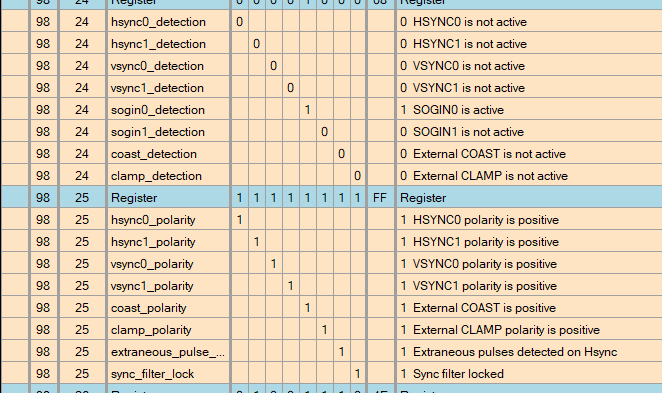

Upon loading AD9984.xml file in AVESBlue, we get these answers on loading settings from AD9984 given below:
PLL of AD9984 is getting locked  can be seen in above screenshot.

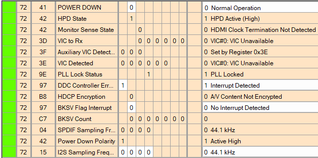

Please note: Given below procedure is not written in the documentation of  EVAL-AD9984AEBZ but still we have managed to monitor the functioning of ADV7511.
Upon loading ADV7511.xml file in AVESBlue, we get these answers on loading default settings from ADV7511 given below:
PLL of ADV7511 is not getting locked can be seen in above screenshot.
Since PLL of ADV7511 is not getting locked, there is no picture on HDMI output.

We were able to secure the PLL lock of ADV7511 as result of above settings as per screenshot given below:
 but still there was no picture output on HDMI Display shown above.
