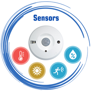

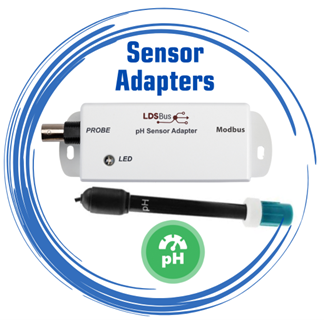

Modbus Products
Our range includes Sensors, Sensor Adapters, and Actuators.
image                             image                                 image

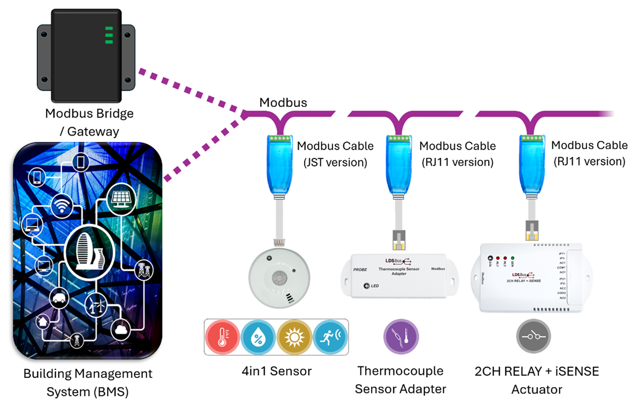

Modbus Hosts
Use our Modbus sensors and actuators with any Modbus host. Ideal for new and existing installations, connected to Building Management System controllers, smart home controls, Industrial controllers, computers, embedded systems and via wireless bridges (for example Modbus to LoRaWAN bridges) to name a few.
Use our Modbus sensors and actuators with a wide range of Modbus hosts in different applications

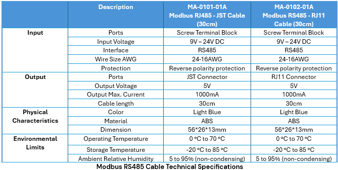

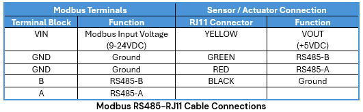

Get Connected!
Our Modbus devices connect via convenient terminal blocks providing Modbus RTU power and data connectivity. Each device is shipped with a corresponding 30cm RS485 Modbus adapter cable to convert the on-board JST or RJ11/12 connector to a 5-way terminal block. Simply connect the RS485 A, RS485B, GND and Power (9-24V DC) to the terminals and connect the JST or RJ11/12 end to the sensor, actuator or sensor adapter.
Connecting to Modbus is easy with the RS485 Modbus cable supplied with each product
The adapter included with each product is shown below:
Modbus Devices and Cable Attachments
MA-0101-01A: Modbus RS485 – JST Cable (30cm)
MA-0102-01A: Modbus RS485 – RJ11 Cable (30cm)

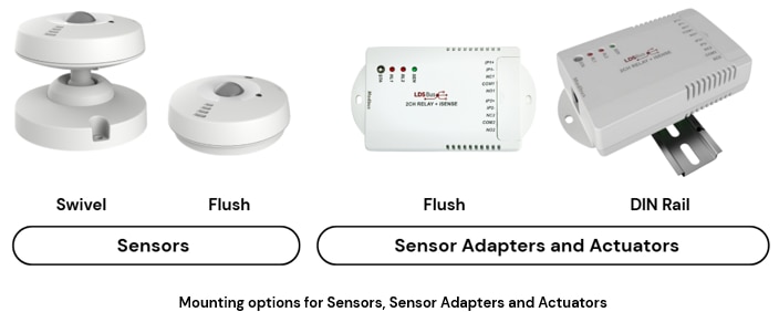

Flexible Mounting Options
Our sensors can be flush mounted on a flat surface or can be swivel-mounted using the optional swivel-mount bracket. Our Sensor Adapters and Actuators can be flush mounted using the integrated mounting ears, and can also be DIN rail mounted via the DIN Rail mounting kit (available separately).
The attractive yet discrete enclosures make the sensors ideal for use in offices, commercial/retail areas and residential applications where the sensors will be visible.
