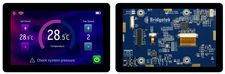

  • Hardware: Evaluation boards like the The final design can use the FT813 Chip or the ME813A-WH50C module.
  • Connections: The FT813 communicates with your MCU over SPI or QSPI. It can also connect to a PC MM4222-QSPI module which acts as a USB‑to‑QSPI bridge.
  • Display: Supports resolutions up to 800×600 with 24‑bit RGB output. Bridgetek have a range of TFT Display Panels which can be used for development and final products.

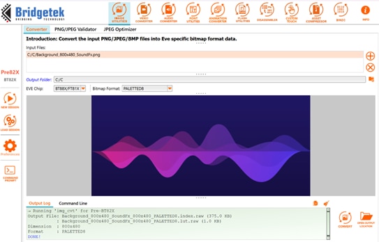

  • EVE Asset Builder: Utility to convert assets such as images, fonts, and sounds etc. for use in EVE. It also includes a custom touch compiler allowing engineers to add support for a wide range of additional touch controllers to the FT813.

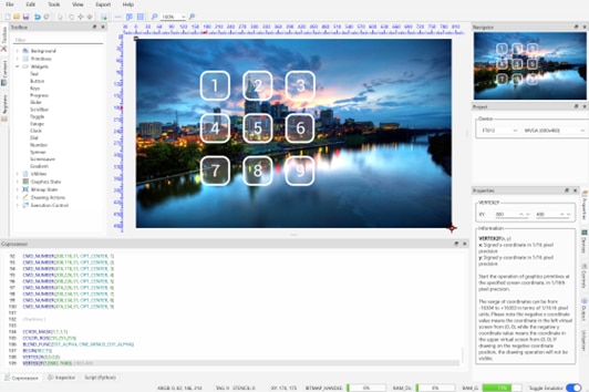

  • EVE Screen Editor: Developers can quickly design and preview interactive display layouts without complex coding via a drag-and-drop interface. It is also ideal for learning about the FT813’s versatile and powerful graphics capabilities with effect such as stencilling, rotating, scaling and alpha blending.

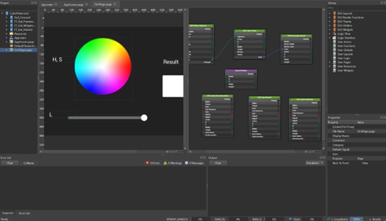

  • EVE Screen Designer: Developers can create, customize, and preview interactive display layouts as well as designing the logic flow between pages. They can then export the code to various MCU platforms.

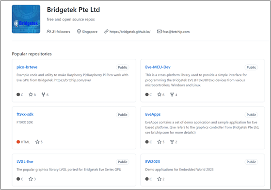

  • Drivers & Libraries: Example code is available for popular MCUs (STM32, ESP32, Arduino and more) on the Bridgetek Github page.

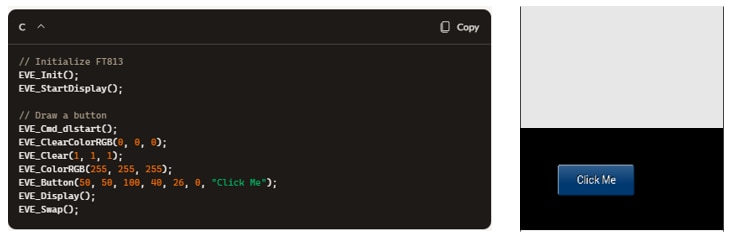

The EVE family of devices use a command-driven object-oriented graphics engine which allows fully featured user interfaces to be created with minimal MCU resources and workload. Here’s a simplified snippet illustrating how developers can initialize and draw a button the FT813. The button is drawn with one command which tells EVE the x and y position, the width and height, the font for the text, options such as 3D effect or flat (pressed-in) and the text to be shown within the button.
The FT813 does the rest of the work to render the button, avoiding any complex graphics processing on the host MCU and freeing it to focus on the main application tasks. This allows the FT813 to be used with cost-effective MCUs which have no graphics capability and have limited resources. It also makes the FT813 ideal for adding graphical touch-enabled user interfaces to existing applications with minimal impact on the workload of the host MCU.
