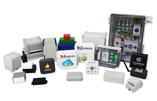

Electrical enclosures are manufactured to offer a protective housing to an electrical or electronic system. At CamdenBoss we design standard ‘off the shelf’ and custom enclosures ensuring environmental compliance and practicality for a variety of applications and industry sectors.

The newest X series range of heavy duty enclosures from CamdenBoss are available in both an ABS and polycarbonate material with either a clear or solid lid option. Both materials have been tested to withstand impact up to IK08 and offer a high level of protection to the electronics housed within.
