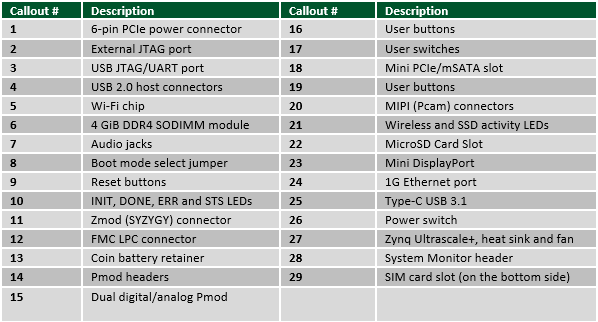

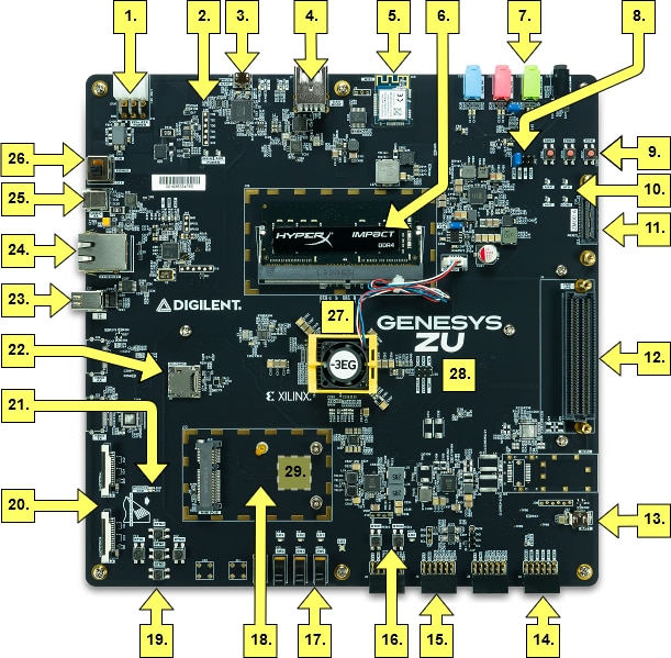

Digilent Genesys ZU-3EG is an advanced computing platform loaded with Xilinx Zynq Ultrascale+ MPSoC EG and a range of peripherals and interface. Let's take a closer look.
Memory
Main memory is a single-slot populated DDR4 SODIMM, always upgradeable by the user. It is wired to the Processing System (PS) side using the hard-core memory controller. The bundled module is a 4GiB Kingston HyperX HX424S14IB/4. There is also a serial flash memory from ISSI. This memory is used to provide non-volatile code and data storage. It can be used to initialize the PS subsystem as well as configure the Programmable Logic (PL). The flash memory is also commonly used to store non-configuration data needed by the application. If doing this from a bare-metal application, the flash memory can be freely accessed using standalone libraries included with a Xilinx SDK BSP project. If doing this from a Petalinux generated embedded Linux system, the flash can be partitioned as desired and mounted like a standard Memory Technology Device (MTD) block device. The microSD connector has a hinge-based mechanism. It is compatible with UHS-I allowing 1.8V signaling and speeds up to SDR104, or 104MB/s.
Platform MCU
Tying all the features of the Genesys ZU together into a computing platform requires an embedded controller which is called Platform MCU. Part of the platform is the coin battery, the fan, a temperature sensor inside the Zynq Ultrascale+ MPSoC EG device and Power Management Units (PMU). Management is done through dedicated signals or over the main I2C bus. The Platform MCU is implemented by a Microchip ATmega328PB. It is on the auxiliary 3.3V power domain, immediately available after power-up. This power domain is independent of the PMUs which provide main power, giving the Platform MCU control over main power. It also shares the main I2C bus with the Zynq Ultrascale+ MPSoC EG device, giving it access to all the critical peripherals. Other features include Zynq Ultrascale+ MPSoC EG device temperature sensing, fan speed control, and VADJ voltage setting. The Platform MCU program memory has two sections:
