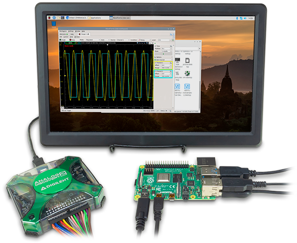

Now, you have access to a complete benchtop by combining the Analog Discovery 2’s oscilloscope, waveform generator, and logic analyzer with the RPi 4 small single-board computer.
The setup guide
Once the Raspberry Pi is all set up with the Raspbian Operating System the Analog Discovery 2 can be set up in 4 simple steps:
1. Download and Install the Adept Runtime for ARM
2. Download and install WaveForms for ARM
3. Connect the Analog Discovery 2Analog Discovery 2 to a USB 3 port and Open WaveForms
4. Select the Device and start taking measurements!
