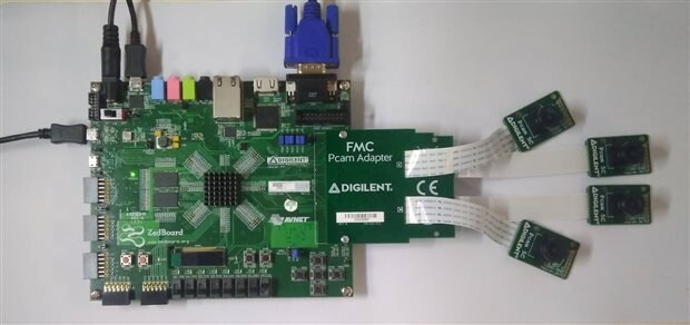

The ZedBoard Advanced Image Processing KitZedBoard Advanced Image Processing Kit was built to use the video processing capabilities of the Zynq-7000 AP SoC's tightly coupled ARM processing system and 7-series programmable logic.
Included in the bundle is a ZedBoard, an FMC Pcam Adapter, and up to four Pcams to create the ultimate video streaming setup. This bundle has everything you'll need for setup, including the ribbon cables for connection to the Pcams and Pcam Adapter.

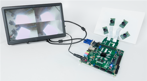

This project demonstrates the usage of the FMC Pcam AdapteFMC Pcam Adapter as an interface from one up to four different PcamPcam cameras and the ZedBoard platform. The video stream from each different camera is getting in through the MIPI/FMC connectors and out through the carrier VGA port.

After you have downloaded the project file, you can walk through steps in the project guide to create the multiple camera streaming application and potentially build the embedded vision system by loading the image processing algorithm.
