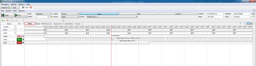

We can look at the boot sequence of the flash on Digilent ZYBO Zynq SoC platform. First of all, you need to use SOIC clip to bring the QSPI signals out and feed them into Logic Analyzer of Digital Discovery.

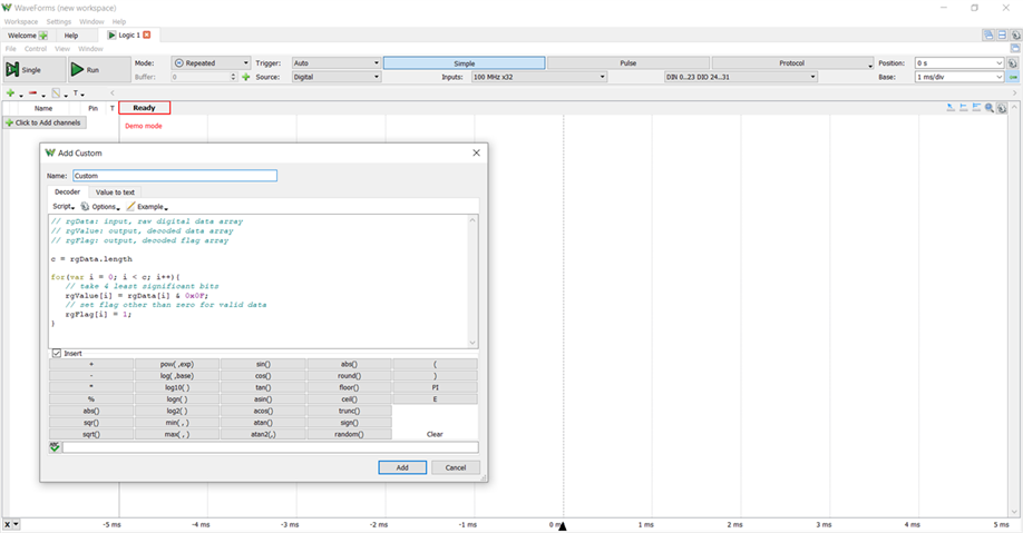

Then, you can use javascript to create the debugging test and translate the signals into data in WaveForms. This can be done by choosing Click to Add Channels -> Custom in the Logic Analyzer.

  pClock = fClock; // previous clock level
Once you turn on Digilent ZYBO, the instructions will be sent from Zynq to the flash memory. You can then visualize the boot sequence in the Logic Analyzer. The application note is available at Digilent Wiki.
