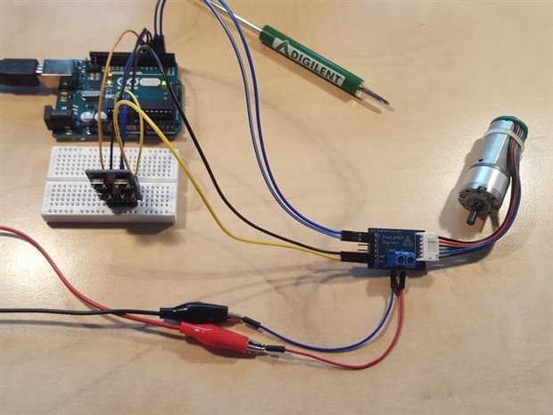

This projects showcase how to use Digilent  Pmod HB5Pmod HB5 H-bridge driver and Arduino Uno to drive the DC motor. The Pmod HB5 offers a 2A H-bridge circuit to drive small- to medium-sized DC motors. Two sensor feedback pins are incorporated into the motor connection header and are specifically designed to work with the Digilent motor/gearbox, which incorporates quadrature encoder feedback. An Arduino Uno can be used to control the motor direction and speed. Digilent Pmod BTN pushbutton let users input the speed and direction.

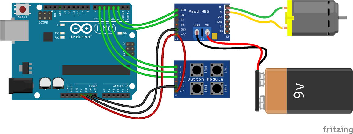

First of all, you need to connect the Pmod HB5 and Pmod BTN to Arduino Uno. To drive the DC motor, you need to connect a 9V battery to Pmod HB5.
Wiring instructions:
Pmod HB5 <----------> Arduino Uno <----------> Pmod BTN
  VCC               to                5V                 to       VCC
  GND              to                GND              to       GND
  DIR                to                  2                  to       -
  EN                 to                  3                  to       -
  -                     to                  4                  to       BTN0
  -                     to                  5                  to       BTN1
  -                     to                  6                  to       BTN2

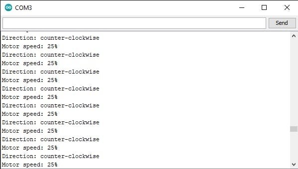

  The motor speed is displayed on the serial monitor.

The direction and the speed of the motor are displayed in the serial monitor.
