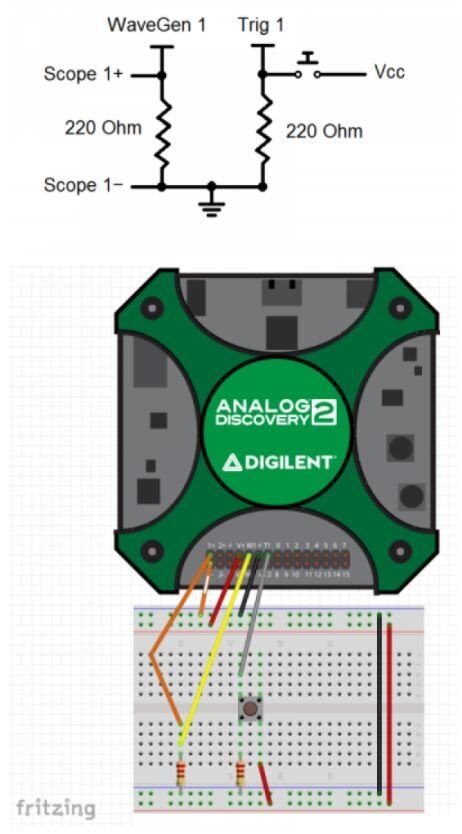

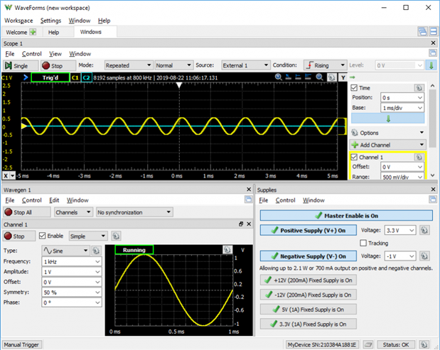

Trigger the measurement in oscilloscope with a push button
This is an example of using an analog signal to trigger the oscilloscope. When you press the push button, it will generate a trigger. The trigger point should change each time the button is pressed since no condition is set to be displayed at t=0.0 seconds

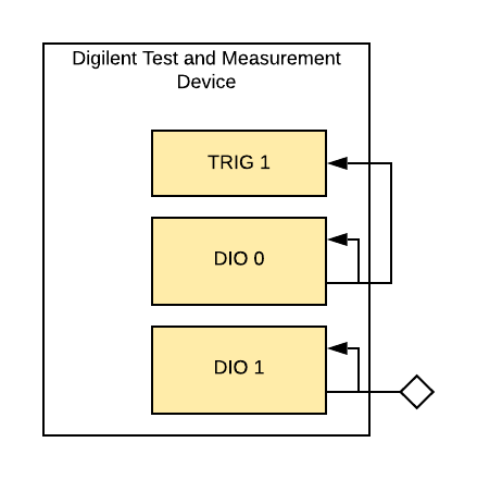

Record Digital Signals in Logic Analyzer with Automated Trigger
This is an example of using a digital signal to automatically trigger the logic analyzer.  Digital input/output pins (DIO0 and DIO1) will be used to stimulate the external trigger and to provide some data to be read. A clock signal from DIO0 is used as the trigger.  A random logic signal at a rate of 10kHz is generated on DIO1 which is being observed in the Logic instrument on the respective DIO1 signal line. DIO1 should update every two seconds in the Logic Analyzer with every rising edge of the clock signal from DIO0
