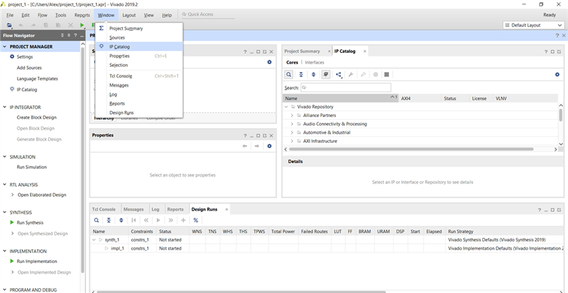

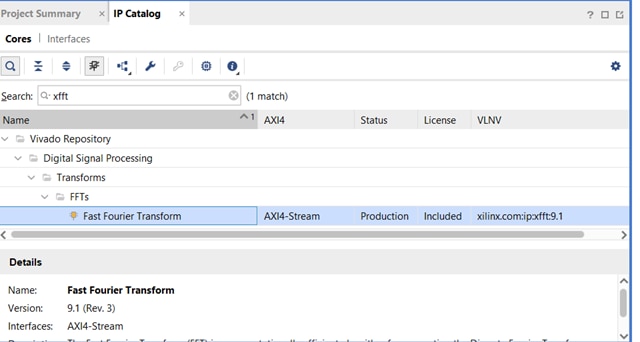

First of all, you need to add xFFT from the IP catalog.

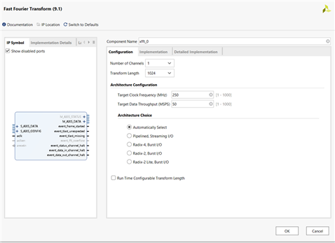

Then, you can configure the IP by
  1. Setting the number of channels and number of samples,
  2. Choosing FFT algorithm.

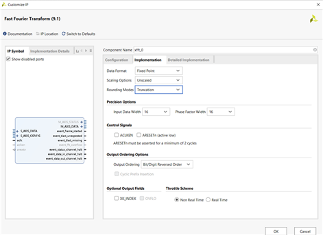

  3. Scaling options
  4. Data format
  5. Output ordering

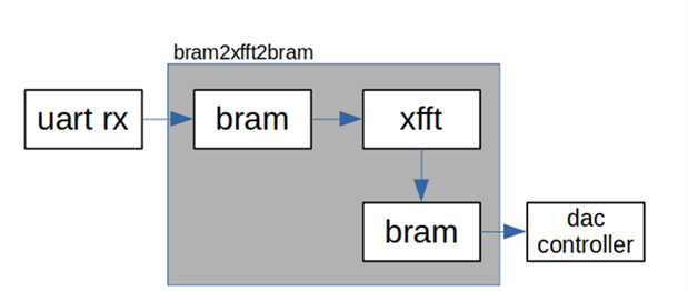

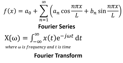

Once the xFFT IP is configured, you can implement the harmonics design. The below block diagram shows Pablo's design. Other than the xFFT IP, he uses AXI-Datamover and AXI-FIFO for data storage and transfer. The input is stored in the first BRAM and then transferred to FPGA through UART.
Pablo design's block diagram (source: https://www.controlpaths.com/2020/05/25/eclypse-z7-and-xfft/ )
