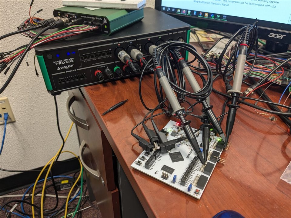

Digilent recently introduced the ADP5470 and ADP5490, two new models in the Analog Discovery Pro 5000 Series. Both are four-channel mixed-signal oscilloscopes with significantly higher bandwidth and sample rates than previous models. To test their capabilities, a project was built around measuring how fast Pmod I/O pins on an FPGA can switch — a key performance factor in many digital designs.

The test was run on an Arty S7 FPGA board. The design exposed the Clocking Wizard settings through a serial interface, allowing a Python script to adjust the frequency dynamically. An ADP5490 oscilloscope was then used to capture and analyze the output waveforms on the Pmod I/O pins. The goal was to determine whether the digital signals still met the LVCMOS logic thresholds at different frequencies.

All measurements were taken with only the FPGA board and the scope connected. No external modules or Pmod peripherals were attached. In a real setup, connecting other hardware would change the signal characteristics due to additional loading and parasitic effects. Results may vary depending on what’s connected to the system.

    michaelkellett over 1 year ago
    I'm sure I've seen an article very like this from some time ago. Then, as now, the experimental technique was quite inadequate and the information provided insufficient to determine the sources of error.
    It is not possible to accurately measure 100MHz+ signals with huge loops of earth wire to the scope probes.
    The article does not state what probes were used.
    The settings of the 5490 were not discussed.
     There is an error in your post:
    At 60 MHz, the signals still transitioned cleanly, but the waveform edges showed slower slew rates
    The slew rate is about the same at 10MHz and 60MHz but the effect on the waveform shape is 6x more significant at 60MHz - the original article explains this properly.
    There is a lot of information on the web about probing techniques for high speed signals. Shabaz has posted some low cost ideas on E14.
