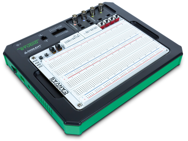

Analog Discovery Studio: The Portable Circuits Laboratory for Everyone
Provides an entire stack of benchtop instruments with a convenient breadboardable interface
The Analog Discovery Studio is a fully-functional portable test and measurement device that can
turn any cross-functional space into a pop-up electronics laboratory. Equipped with 13 instruments including an Oscilloscope,
Logic Analyzer, Spectrum Analyzer, Waveform Generator, and more; the Analog Discovery Studio provides an entire
stack of benchtop instruments with a convenient breadboardable interface, perfect for enabling circuit design anywhere!
Its durable enclosure measures 1.25 x 9.25 x 7.5 inches and fits on a bench, desktop, or backpack. Users can access the
Oscilloscope and Waveform Generators via breadboardable MTE cables, or industry standard BNC cables, and the Logic
Analyzer, Pattern Generator, and Triggers can be accessed via MTE cables. Circuits or designs can be built on the included, magnetically connected Breadboard Canvas and conveniently swapped out or removed for transit, making the transition
from working in the lab to working at home as seamless as possible. The Breadboard Canvas also includes power supply
outputs controlled by physical switches, common I/O built-in, and a large breadboardable surface.

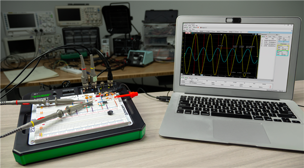

    Nice packaging design. Depending upon price, this could be a good product. DAB

    For school labs this can be good value. You don't need a lot of bench/shelf space, and you have power supply, wave generator and oscilloscope readily available.
    That's enough to do lab experiments with passive components, semiconductors, opamps.
