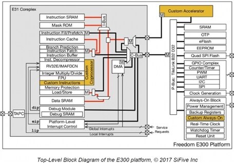

The Arty A7-100TArty A7-100T contains a Xilinx XC7A100T FPGA which is the largest FPGA available for the Arty A7Arty A7 and is ideal for deployment of softcore processors. These processors can be either proprietary or open-source. One of the most popular open source processors is the RISC-V.
This tutorial covers building a RISC-V processor, specifically the SiFive Freedom E310 and steps through the process of loading the Freedom E310 onto an Arty A7, and programming it using the Arduino IDE.
Topics include:
  • Getting Started
  • Building the RISC-V
  • Programming the Hardware
  • Generating Software
What do you need for this project:
  • Arty A7-100TArty A7-100T
  • Olimex ARM-USB-TINY-H USB Programmer
  • Vivado 2017.1 – Webpack Edition
  • Arduino Development Environment
  • 10 Flying leads to connect between the programmer and one of the Arty's Pmod connectors, which is connected to the JTAG Test Access Port of the processor
  • A Linux development or virtual machine is needed to compile the processor, generate the bitstream and upload applications to the processor.
Walk through the tutorial and create your RISC-V based application.
