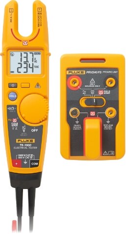

The first goal of any electrician or technician who works around live voltage is to go home safe. Traditionally voltage has been measured by attaching test lead probes or alligator clips directly to electrical conductors. This requires metal-to-metal contact that brings with it the risk of arc flash and potential harm to both the person doing the measuring and the equipment being measured.
Fluke FieldSense technology offers a safer way to measure voltage by isolating the measurement tool from the voltage source under test. This reduces the risk of electrical shock and arc flash. Through the principle of galvanic isolation, FieldSense allows electricians and technicians to measure voltage without exposing themselves to contact points with live voltage. Instead, a FieldSense-enabled test tool such as the Fluke T6-1000 Electrical Tester senses the electrical field in the open fork and measures the voltage through the cable insulation. Commercial and light industrial electricians can use FieldSense-based devices for voltage and current measurements, verifying continuity values, and testing individual circuits. Here are the top five ways this non-contact voltage measurement technology can help you work safer:

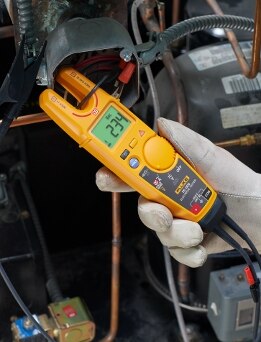

1 - No metal-to-metal contact when measuring ac voltage
In the past, measuring voltage has required metal-to-metal contact. You had to either attach probes or alligator clips to the conductor, which immediately put you at risk of spark or arc flash. Fluke FieldSense technology allows you to measure ac voltage, current, and frequency through the cable’s insulation by sliding the fork of the tester over the conductor. There is no direct electrical contact with live voltage so there’s much less potential for electrical shock or arc flash. You can work safer and faster. FieldSense technology does require a capacitive path to earth ground which, with the T6 electrical tester, can be made in one of two ways.
You can create a capacitive path to ground by first firmly inserting both test leads into the storage dock on the back of the tester, then placing your finger firmly on the ground touch point on the back of the battery cover. Next, slide the fork around the ac conductor. The second method is recommended if you are wearing safety gloves or are otherwise insulated from ground. In that case, you simply touch or clip the black test lead of the FieldSense tester to a grounded conductor such as a conduit or junction box.

3 - Reduces the need to open panels because you can access wires at junction boxes
FieldSense-enabled devices don’t need access to wire end points so you can take a measurement at any point along the conductor. This makes it much easier to quickly measure ac voltage and current on traditionally inaccessible measurement points such as crowded junction boxes. All you have to do is slide a single conducting wire into the open fork, read the results, and you’re done in no time.
4 - One-handed voltage measurements
Because FieldSense technology eliminates the need to fuss with test leads, in many cases, you can accurately measure voltage with one hand. The open fork form factor makes it easier to isolate individual hot and neutral wires, which in turn helps reduce the chance of accidental contact with another voltage point and the likelihood of errors. You’ll save time…and perhaps a lot more.
5 - Combines with proving unit to verify proper operation
A key requirement for any test tool, before you use it for live voltage tests, is to verify that it is working properly both before and after taking a measurement. And you want to be able to do that without unnecessary exposure to shock and arc flash. The PRV240FS proving unit sources 240V of continuous ac voltage to allow you to safely verify that your FieldSense electrical test tool is working properly before you conduct live tests. It’s a good practice to test your tester both before and after live tests, to ensure safer and more accurate measurements.

    We agree that when testing for absence of voltage, a two-pole tester should always be used. Two-pole testers, such as the Fluke T110, T130 or T150 are specifically
    designed to be able to detect the presence or absence of voltage even when the batteries are missing or depleted. The T6 is not. The T6 is designed to be a
    convenient, frontline troubleshooting tool with which you can get a quick voltage, current or continuity and resistance measurement. Regardless of which
    tool you’re using, though, it’s always good practice to verify your tool against a known voltage source both before and after your measurement. There are
    various ways of doing this, but to make it more convenient we offer the PRV240FS which is designed to not only be able to test tools with test probes, such as a two-pole tester, but also the T6 with FieldSense. The PRV240FS should provide 1100 tests and includes an automatic shutoff after 10 seconds to try
    and preserve battery life.  As an alternative, for those customers who don’t have a T6, we also offer the PRV240 proving unit which can source ac or
    dc voltage but can’t be used to test FieldSense. The PRV240 is designed to be able to provide 5000 individual tests. We would like to replace the PRV240FS
    with the PRV240 that may be more suited to your needs.  If this is the case, please provide us with a ship to address to send you the replacement.
