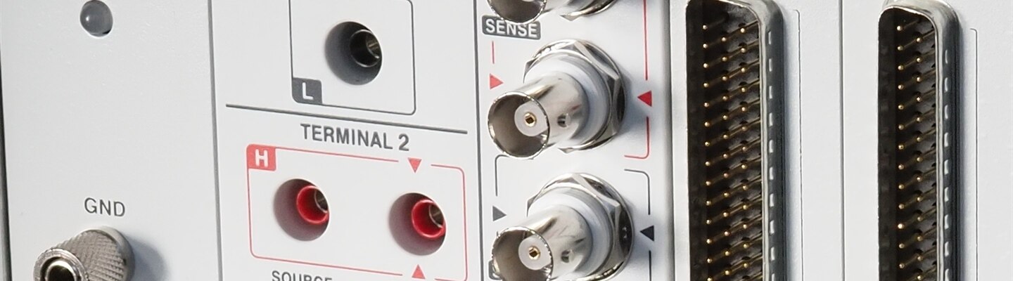

HIOKI's SW9001 multiplexer

The most common use-case for 2-wire measurements are voltage measurements with a digital voltmeter like HIOKI's DM7275 . The meter would be connected to "Terminal 1" of the multiplexer, with the multiplexer module of choice being the SW9001 (the module on the left in the above image).
4-wire measurements are typically resistance measurements with the above mentioned RM3545 or battery / cell tests with a 1kHz-ACIR battery tester like HIOKI's de-facto industry standard BT3562A . Here, the meter would be connected to "Terminal 2" and the multiplexer module would always be a SW9001 module.
4-terminal pair measurements require 6 wires instead of 4 because an additional two wires are required for the return current which helps to keep effects of eddy currents to a minimum. The instrument in question is HIOKI's BT4560  battery impedance meter. It connects to the multiplexer at "Terminal 3" and requires multiplexer module SW9002. In case you wonder: The shields of two coax cables are used to carry the return currents.

If you plan to use the SW1001 or SW1002 for 2-wire or 4-wire measurements with SW9001 modules, then a suitable cable available in Europe is from LAPP Group and it's called UNITRONIC LiHCH (TP) 25x2x0,14 (item number 0038325). This is the version with 25 twisted wire pairs of the cable. However, should you require less wire pairs or should you prefer to split the harness then you can of course choose other versions of this cable. The cable is available in the length you need it from LAPP's online shop.
As a connector you can use any DD-50 female D-sub connector, for example one made by HARTING Technology Group (item number 09 67 050 4704 ).
If you plan to use the SW100x for 4-terminal-pair measurements (i.e. with HIOKI's BT4560 battery impedance meter and SW9002 modules), then a suitable cable is called "RG 174 UR" from Caledonian Cables. Please bear in mind that there is a big difference regarding the cable resistance between a normal "RG 174" and this "RG 174 UR" cable. The normal RG 174 which you can find everywhere does not meet the requirements for use with the SW9002.
As a connector you can use any DC-37 female D-sub connector, again for example one made by Harting (item number 09 67 037 4704 ).
