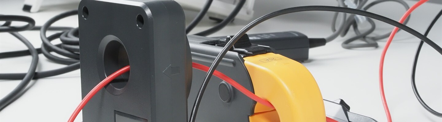

  • HIOKI's CT6711  is the flagship model in the portfolio of wideband zero flux AC/DC current probes. It is hall sensor based, features a bandwidth of 120MHz, is typically used with oscilloscopes or recorders, and has three current ranges to choose from: 0.5A, 5A or 30A. With our 50W bulb powered by 12V the 5A range is perfect for our measurement
  • HIOKI's CT6841A  is a 20A zero flux current clamp. It is made for power measurements and uses a fluxgate instead of a hall sensor
  • HIOKI's CT6872  is a 50A zero flux current sensor. Like the CT6841A it is also made for power measurements and also uses a fluxgate instead of a hall sensor
