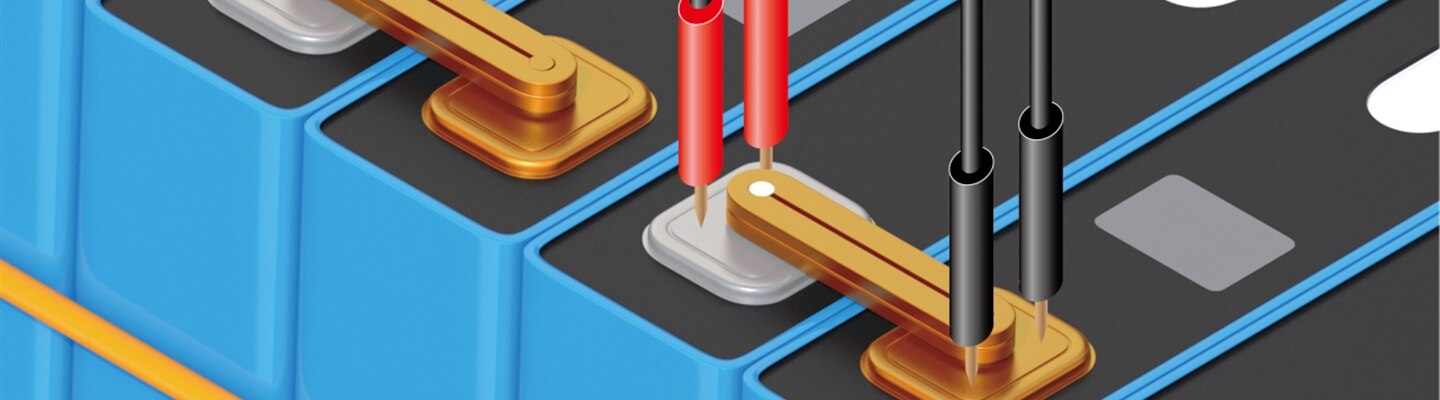

Resistance of welding joints
When determining the contact resistance of welding joints, the traditional 4-wire DC resistance measurement method is used. Regardless of whether these welding joints are intended to attach power terminals to a pouch cell or to connect a cell to a busbar – the contact resistance should always be checked afterwards to avoid introducing resistance-dependent heat sources at these points.
4-wire DC resistance measurements can be made with almost any digital multimeter for laboratory use or industrial use. However, when measuring the contact resistance in production, there are some important reasons to make the measurement with a resistance meter that is specially designed for this purpose.

If you imagine a measurement setup with the above-mentioned 132 channels, which are used, for example, to measure the welded contacts for connections to busbars on a battery module, the 4-wire measurement method not only requires more than 500 test leads, but also more than 250 mechanical test contacts. From a technological perspective, this is possible. However, especially for cylindrical cells in a module, another solution is preferable – a flying probe tester with the somewhat cryptic name FA1240-W800. These devices are commonly used for testing assembled PCBs, and are capable of performing 4-wire resistance measurements, among other things, in as fast as 25 ms per test. After all, it does not matter whether the device under test is an assembled PCB or a battery module where welding joints are measured.
HIOKI FA1240 flying probes tester
The use of a flying probe tester in the example of measuring welding joints of battery modules has another advantage over the arrangement with fixed test contacts – be it in the variant described above or alternatively with a “bed of nails”; because while the test positions are always the same on assembled PCBs, they always deviate slightly from each other on battery modules with hundreds of cells due to production tolerances. However, the welding joints must be measured precisely.
Therefore, the FA1240 flying probe tester allows for loading a position file for each battery module beforehand. This file can be created individually for each battery module with the right camera and a suitable analysis software. Measurement errors due to mechanical production tolerances are ruled out in this way.
