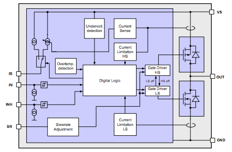

The shield is built around two BTN8982TA: a high current half bridge for motor control applications.
The BTN8982TA package consists of:
  • a driver circuit
  • one p-channel highside MOSFET
  • one n-channel lowside MOSFET
Offering:
  • logic level inputs (driver circuit)
  • high PWM frequency control capabilities
  • various protections, such as: undervoltage, short circuit, overcurrent and overtemperature
  • diagnosis with current sense
  • adjustable slew rates (fixed on the shield though)
source: BTN8982TA datasheet
