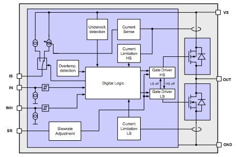

The shield is built around two BTN8982TA: a high current half bridge for motor control applications.
The BTN8982TA package consists of:
  • a driver circuit
  • one p-channel highside MOSFET
  • one n-channel lowside MOSFET
Offering:
  • logic level inputs (driver circuit)
  • high PWM frequency control capabilities
  • various protections, such as: undervoltage, short circuit, overcurrent and overtemperature
  • diagnosis with current sense
  • adjustable slew rates (fixed on the shield though)
source: BTN8982TA datasheet

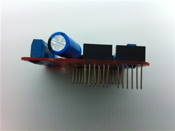

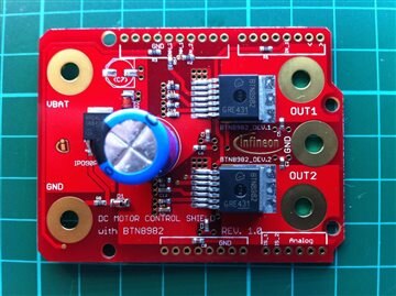

First observations
Out of the package, the board looks very well made and of high quality. There are however a few things that immediately drew my attention:
  • no headers on the board or in the box
  • a huge vertically mounted capacitor
  • no (screw) terminals, but instead big ring shaped pads
Top and bottom view of the shield

Huge capacitor
The huge capacitor in the middle of the board really sticks out: about 25mm! One of the advantages of the BTN8982TA, is that it has very low board space consumption for the features it offers. I personally feel the capacitor obsoletes that advantage completely. It also prevents other shields to be stacked on top of this one, which seems like a big problem as other shields with displays or prototyping areas require to be on top.
Couldn't the capacitor have been put on its side ?

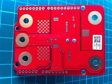

No (screw) terminals
One of the things I liked very much about the RGB LED Shield, were the screw-less terminals for both the power supply and the RGB LED strip. I was expecting something similar for this shield, but instead found big ring shaped pads. This will require soldering as opposed to the terminals, which makes it less practical for testing different types of motors and power supplies.
Is there a specific reason (except cost), why pads would be better than (screw) terminals ?

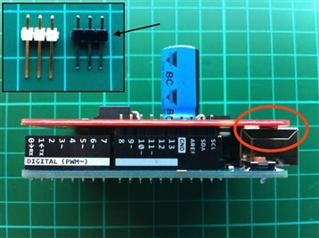

Headers
I've ordered tall stackable headers for Arduino, but it will take some days until they get here. In the mean time, I've been experimenting with what I had at hand.

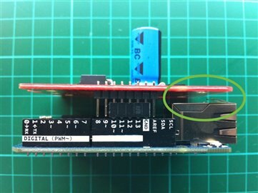

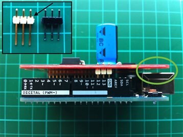

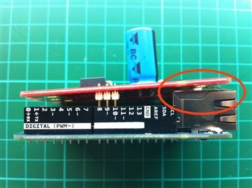

The first tests was to use different size male headers with an Arduin UNO. Using the typical size male headers, there was contact between the shield's VBAT connector and the UNO's USB port, which would create a very nasty short circuit. With a different size male headers the problem was resolved for the UNO.
Testing different size headers to avoid contact between shield and USB port on the UNO
The next test was about finding suitable headers for the YUN. The Arduino YUN has a vertically mounted USB port and an ethernet port, which are sure to cause problems as they are taller than the UNO's USB port. The tall headers working for the UNO were too short for the YUN and had to be combined with intermediate female headers.
Finding an appropriate combination of headers for the YUN
I'll be posting an update as soon as I receive the tall stackable headers I've ordered. In the mean, this will have to do image

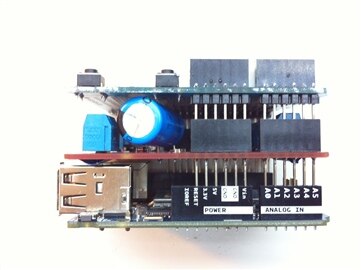

image UPDATE: Extra tall stacking headers have arrived! The clearance for the YUN is just enough, I did put some tape on the bottom of the shield to avoid direct contact. With the capacitor on its side, it is possible to plug in another shield on top of the motor shield, although it should have long headers.
Motor shield with extra tall stacking headers

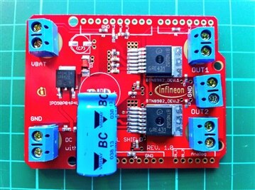

There are two modifications I made, based on the feedback given during my first observations: laying the capacitor on its side and using screw terminals.
Screw terminals and capacitor on its side
