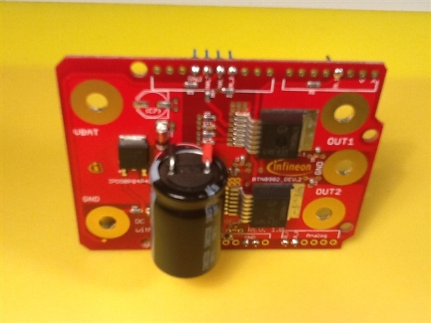

The DC Motor Driver shield is Infineon's evaluation board for their very capable 1/2 H-Bridge driver IC BTN8982 .
They have designed a nice and easy to use schematic in the Arduino form factor. That makes it easy to set up a test bed to evaluate the drivers.
That design form is also a reason for annoyance. It's a great product that can find its way into many motor applications - but the shield is not done right.

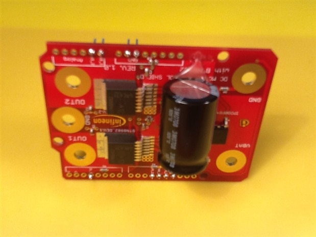

When you unbox the shield you stand in awe. A very nice (yes: beautiful) board. Much thought has been put in heat management - that is so well executed that it can serve as an example on how to deal with heat on a PCB.
Then you try to stack it on an Arduino Yun, or even the most used UNO. And that doesn't look good. The high power contacts are straight above grounded connectors. If you want to use bolts or decent connectors for the high current wiring, you have to use multiple stacking headers to get a safe clearance.
Then you try to stack an LCD shield on top. The big upright cap is in the way of any shield out there in the market. So in stead of evaluating the drivers, the reviewer will spend time in replacing that cap, ordering an extra batch of stacking headers, and throwing arms in the air.
And as extra fuel on the fire, the example code that is announced in the Quick Start Guide (typically the first thing you look for when acquiring a shield), it's not there. either that, or I am blind and can't find it.
It's a shame. These easy to avoid design decisions will blur reviews that otherwise would have been all positive. And the H-Bridges deserve a positive review.

    Is it permissible for a "compatible" shield to have edges that overhang the host board? If so, surely that would be a sensible place to locate components such as the capacitor and motor connections.
    Jan Cumps over 11 years ago in reply to gadget.iom
    Yes. But I think that it is possible to make a fitting design within the standard area. Using an axial capacitor and moving the power connectors away from directly above the metal grounded parts would have done the job. There is space enough to fit this design in a better way.

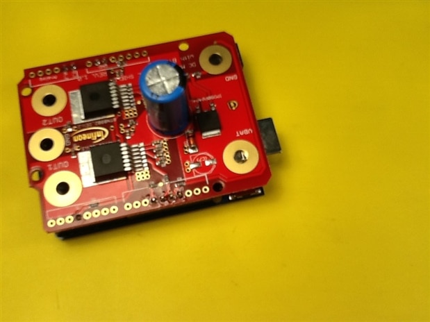

    Jan Cumps over 11 years ago in reply to DAB
    This is how the board looks like now.
    I need an add extra layer of stacking headers when mounting it on an Arduino. The leeway between the two boards is not enough with the stackers I've used.
