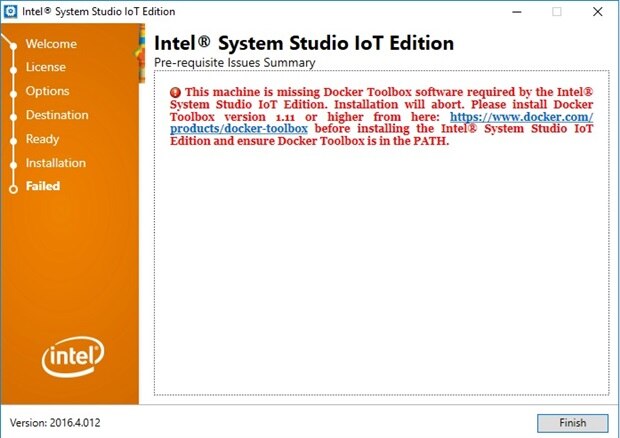

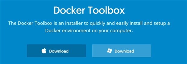

The first was a program called Docker.
https://www.docker.com/products/docker-toolbox
Docker is some sort of compiler helper that wraps programs in a container with required libraries and such.  I'm not sure yet exactly what it helps.

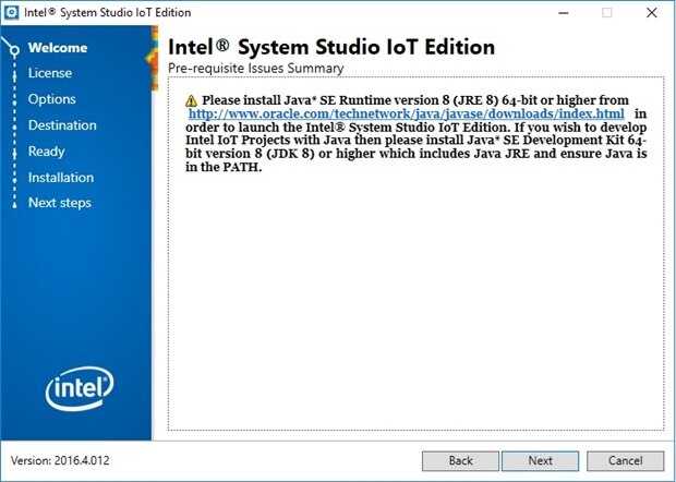

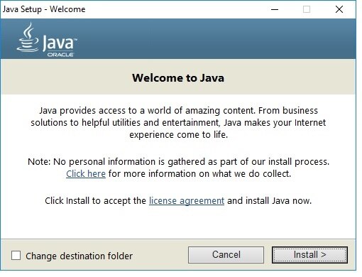

The next thing the System studio installer complained about was JAVA JDK and RE
You can't just load the RE, or the compiler will complain later requiring the JDK, since the JDK includes the RE, just install the JDK.
Clear as mud, eh?
