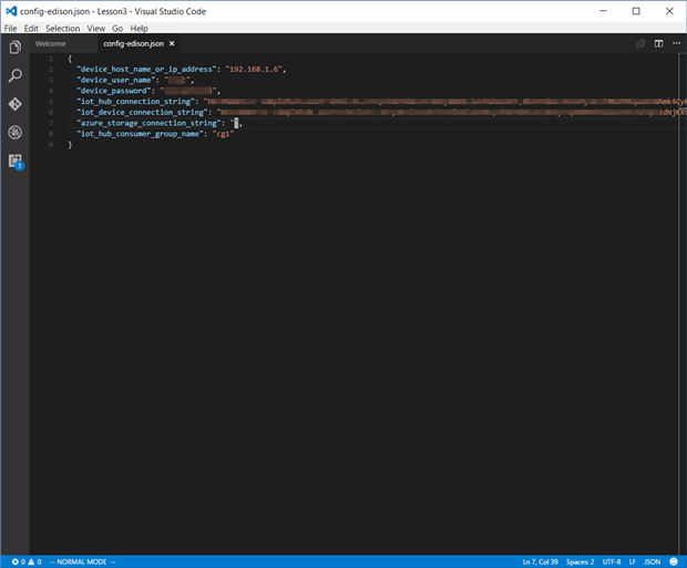

2. Update configuration file config-edison.json in Visual Studio Code.
# For Windows command prompt
code %USERPROFILE%\.iot-hub-getting-started\config-edison.json
# For MacOS or Ubuntu
code ~/.iot-hub-getting-started/config-edison.json
3. Make these changes in the configuration file:
  • Replace [device hostname or IP address] with the device IP address you marked down when you configured your device.
  • Replace [IoT device connection string] with the device connection string
  • Replace [IoT hub connection string] with the iot hub connection string
Deploy and run sample application
1. Deploy and run the sample application on Edison.
gulp deploy && gulp run
