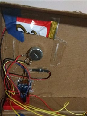

I haven't wired ALL of the directional sensors yet, only needing two to ensure the programming allows multiple to be run at once. As I'm programming in Python, it requires the multi-threading module, and programming with it can be odd or unpredictable, at least to some degree.
-Coding the sensors:
I am trying to run a thread per sensor, to turn on an LED (connected to the GPIOs) on/off using MRAA. However, because of limited GPIOs, I'm working one using "trigger" on all sensors, then trying to read them all at once. It seems to sometimes return duplicates, but that was also before I found a bug in my code with multi-threading. Each sensor has an echo (input) and trigger (output) pin, that you have to use a script to detect distance based on the time the trigger was sent, to the time that frequency coming back to that sensor.
I'm considering to look back into SHARP sensors, if I can find any to read more than 1.5ft away. I do have a sensitivity knob connected to it, to change the setting based on ambient light.
The sensitivity knob is where I've run into my latest hitch in programming: I'm using an SSD1306 I2C screen. If you want to know more about programming for it, I made a post asking for help (and answering it a day later) here: Live Update of OLED module in Python
My current problem, and I do have a post for it, so I will link it as well when I get an answer, is:
Once I try to read the rheostat input I'm trying to read in MRAA (again, using Python), the screen refresh stops working. If I call the analog input first, the screen will never even turn on.
I plan to double-check my threads later, but I didn't see a problem there last few times I checked.
-Wiring:
I'm wiring the panel, with screen, LEDs, to all connect at the back to a screw terminal, to connect to the Arduino and external sources from that point. This allows me to interchange one part at a time later, as I make sturdier parts, or want to change something. It also allows for easier prototyping, where I can jump one screw to another to another to test if something is not powered or grounded properly, or is malfunctioning from software, instead.
For example, I had a LED stop working even though the sensor was connected and script was running to make the light blink when the sensor is covered. The light did not light up. I used a jumper to run power to the LED terminal (3rd from right), and it did not turn on. All LEDs share a common ground with my setup, so I jumped a voltage to #3 (from the left), and ground to the black... it turned on. I use a miniature breadboard inside the control panel, which allows me to manually control or bypass sensors or controls if there's a malfunction.... because as I said at the convention several times, SAFETY FIRST!
Okay, so I'm kinda pleased with my organization and soldering here, lol.
And yes, that's a chip bag, I'm using for a reflector behind the LEDs. I'm using acrylic pieces off a Samus Helmet I was making buy got damaged. I just broke it off, and glued the pieces onto here, for protection to the LEDs.
I went through the breadboard, tested leads, and YUP! A bad ground. Fixed it, and jumped it again....
So, of course it worked again after I restarted the script! ^_^
Yet, I'm still having trouble on the MRAA not reading analog unless it stops sending commands to the screen.....

  • vandia
    vandia over 9 years ago in reply to rsc +2
    As it turned out, the Atmega pin used for I2C is shared with Analog5. I changed the pin, and it worked. My next blog post will include a link for that problem, where I listed all pin conflicts. I also…

    As it turned out, the Atmega pin used for I2C is shared with Analog5. I changed the pin, and it worked. My next blog post will include a link for that problem, where I listed all pin conflicts. I also will be breaking this into individual blog posts, as I saw that's what others have done, and since there's no spoilers/condense option, I feel it will make posting and browsing easier for people that way as I add dates, because I am picking up the pace on the project now I've all my stuff moved in to my house.
  • rsc
    rsc over 9 years ago in reply to vandia
    If your LCD library thinks you have a touchscreen installed, it might be trying to use your analog inputs for touchscreen routines.  I've been having the same issue with the LCD library I'm using turning on the analog input pullup resistors during initialization.
