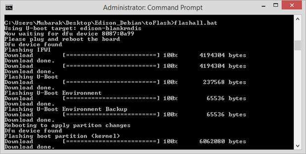

Once there, the flashall.bat script was executed by typing flashall.bat at the command prompt. A few messages will appear and ask that the board be rebooted and then plugged in.
I was powering the Edison using the USB slave port (the micro USB port immediately below the full-sized host port), so at this point I simply plugged the board in. The script automatically detected the board and went ahead to flash it. Here’s a photo of what I got.

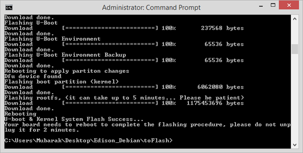

And after about six or eight minutes, I arrived here:
Once this was done, as per prompt above, I left the board plugged into the PC for a short while (about six minutes just to be safe). Next, I plugged in the serial cable (into the other micro USB port, below the power/debug/slave microUSB port). Normally I’d have needed to install the FTDI drivers to get a serial port when I plugged the cable in, but I had already installed the FTDI drivers (at some point in the past, for one of my Arduino boards). The takeaway here is that on plugging the serial cable in, a new serial port should be available on your computer. On Windows, it’d typically be called USB Serial Port (COMxx), where xx is the port number. Noting the port number, I pulled up PuTTY (any other terminal emulator will most likely serve also) and opened a connection using that port at 115200 baud (I don’t think it makes a particular difference really). I had to hit the Enter key once before I got a login prompt.
