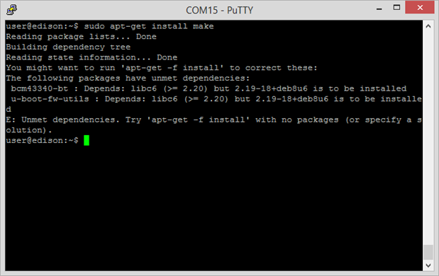

At the barest minimum, you’d need the following packages to attempt to build basically anything at all: make, build-essential, gcc and cmake. Therefore, this process began with a “sudo apt-get update”, which was to be followed by “sudo apt-get install make build-essential gcc cmake git”. First command completed without a hitch. The second command gave the following error:

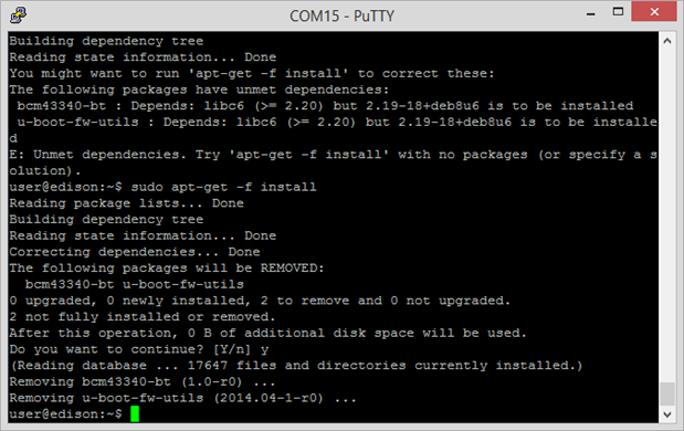

Weird. I figured I didn’t need the bcm43440-bt package because I wasn’t really using Bluetooth and had already inserted the necessary Bluetooth files into the image. Same thing for u-boot-fw-utils, since I’d already finished with u-boot and could easily interact with it at boot time. So I followed the recommendation, which asked to remove the two packages. I assented, and when that was completed, was able to install the build tools without a hitch. This is how it went down.

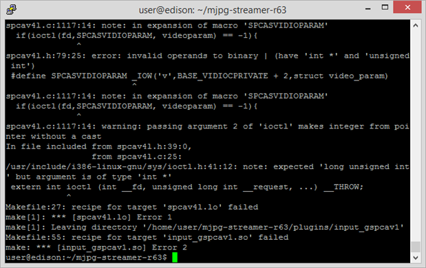

Once that is done, we can now go ahead and compile mjpg-streamer. Within the mjpg-streamer source tree (i.e the folder containing the folders plugins, scripts, www), execute the “make” command. For some reason, this failed to complete the compilation at some point. The error wasn’t really clear to me, but it would appear the failure occurred during the compilation of something related to GSPCA, which is not used here. Here’s an image showing the error.
Despite that, the main mjpg-streamer binary, the UVC input plugin (which is what is used to capture video from USB video devices like webcams) and the HTTP output plugin (which is what is used to provide a browser-viewable MJPG stream) were successfully compiled. I plugged a webcam in, and executed the following command (from within the mjpg-streamer source tree):

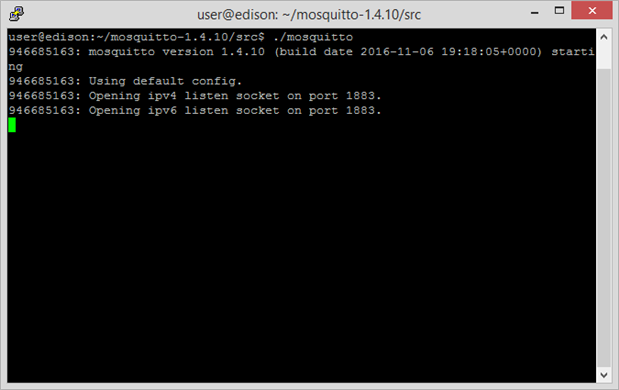

In the Mosquitto source tree, there’s a file called config.mk. With your favorite editor (nano works great) locate the line that reads WITH_WEBSOCKETS:=no and change that no to a yes. Once that’s done, save and run make from within the source tree. When that completes, you should have the mosquito broker itself inside a folder called src in the main source tree. To do a test run, type ./mosquitto while within the src folder. If everything went well, you should see messages similar to those below:
This may not be particularly useful at the moment, so a Ctrl-C will end the process. Mosquitto is a broker, so in practice you probably want to run it at boot or in the background/as a daemon. We’ll talk more about it later.
