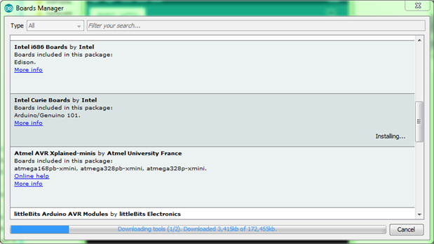

Getting started with the Genuino 101 takes a little more work compared to the Uno. The first prerequisite is to have Arduino 1.6.7 or later installed. Just plugging the board in will bring you no joy though ...
The reason is that this board needs very specific drivers. As a result, you have to fire up Arduino and go to the Boards Manager, where you need to download the specific "core" to support this board. A warning, the download of the Intel Curie core is about the same size as Arduino IDE itself, so you're probably going to use up about 400Mb getting the IDE and the support package.
Once it has been downloaded, the package will run its installation and install its drivers.
From there, you can use the IDE as per usual, with Arduino/Genuino 101 selected as the board type and with its corresponding COM port. To access the Curie specific features, you should reference the library pages on Curie Timer One, Curie IMU and Curie BLE. For someone like myself who has never developed with the Curie before, or with Arduino for a while, it was a lot to process, and I found it easier to leaf-through the example code instead of going through the library reference.

One frustration that I had encountered was a very slow build and load process, and partly it seems, due to issues with the way the download script attempts to reset the board. On my machine, it's very hit-and-miss with a 20% "first time" success rate. However, if you follow and press the MASTER_RESET when instructed, it loads fine. To make things quicker, I note that it often hangs at the "Uploading" prompt - pressing MASTER_RESET right then actually will allow the download script to start and load the program first time.
Another problem I came across was a stuck non-functioning serial monitor, which makes debugging frustrating. What I seemed to find was that even when using Hyperterminal, the serial port just hangs on opening a lot of the time. But after a few plug/unplug cycles, you can get it to open and print as expected, but after that, it gets stuck again once the board is reset. I don't know what the cause is, but it makes frustrating work of the emulated Serial connection.
